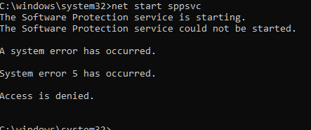

While the error 0xC004F012 has appeared on Settings\Activation when no hardware change or OS operation was underway over a steadfast history, it's been made particularly accented by the fact it stamped itself on two different devices with different editions (Home, Pro) and separate routines.
What's more, automated phone Support for Windows activation implicitly is not including any undefined occurences of Windows deactivation as of uncreditable origin.
So what's advised to do now that a Windows deactivation has occured without previously any of the assigned reasons in place (hardware change or new deployment etc.)?

    Regarding the error code 0xC0000022 from slmgr /upk: This typically indicates a permissions issue or underlying system corruption.
    • Since the error mentions Access Denied when starting the Software Protection service, please double-check that the necessary permissions are in place. Specifically, make sure that Administrators, Power Users, and SYSTEM have full control over the relevant registry keys and services.
    • Additionally, to rule out system file corruption, open an elevated Command Prompt (Run as Administrator) and execute: sfc /scannow This will scan and attempt to repair any damaged system files that might be interfering with activation.

    Like I said, all slmgr command line is ended with the 0xC0000022 error code, but accidentally I found out that in Safe Mode the /dlv cmdlet gave error code 0xC0020036 e.g.
    (no sceen snip available in Safe Mode)
    Windows Script Host
    Error: 0xC0020036 On a computer running Microsoft Windows non-core edition, run 'slui.exe 0x2a 0xC0020036' to display the error text.
    (It's certain the latest key with one device is a retail online for an upgrade to Pro edition and the other device had pre-installed OEM key which was upgraded by Windows Update to a higher version of Home edition, that is, to Home 10.) So this difference probably does not help with why the issue is identical for both devices.
    About the necessary permissions, they all look in place as I was checking with it by way of online ms-partner posts for the particular problem. And recent or older history can't account for any such change in permissions.
    Also the System File Scan looks alright too - no integrity violations.
    (You think though that apps like icacls.exe or takeown.exe could have such a side effect when used to /reset, /grant, or /f the Windows directory? If so, what check-up should point to restoration of Windows activation?)
    As for Windows Update, it's not so easy now to check how it be while the whole personalization block became incapacitated; For example, navigating to Activation or Troubleshoot is functional, but not Windows Update -last time though I was able to check with it, it had completed all tasks.
