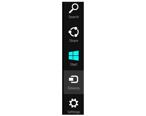

    "Gesture Sign On" you mean Charms Bar? How do you project your screen?
    Best Wishes and Happy New Year,
    Clare
