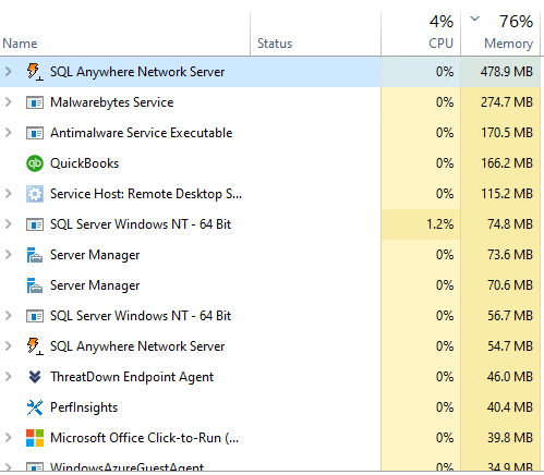

Our VM users frequently report performance issues. We are running the QuickBooks application on our VM, which I believe relies heavily on Microsoft SQL Server. The RAM usage is consistently high, and I suspect the CPU is also under heavy load. Even establishing a connection takes a long time, and once connected, the system runs very slowly and struggles to handle any applications. We kindly need your urgent assistance to address this issue as soon as possible.

To proceed further, we kindly ask that you run the PerfInsights tool and share the report with us. For more details, kindly refer: https://learn.microsoft.com/en-us/troubleshoot/azure/virtual-machines/windows/troubleshoot-high-cpu-issues-azure-windows-vm?wt.mc_id=knowledgesearch_inproduct_azure-cxp-community-insider#azure-portal-option-1
If the report shows any High or Critical impact related to non-azure processes, this will indicate that the high resource consumption is likely due to the usage patterns of the VM.
In that case, best solution is to consider resizing the VM to a larger size, which can help accommodate the increased demands.
