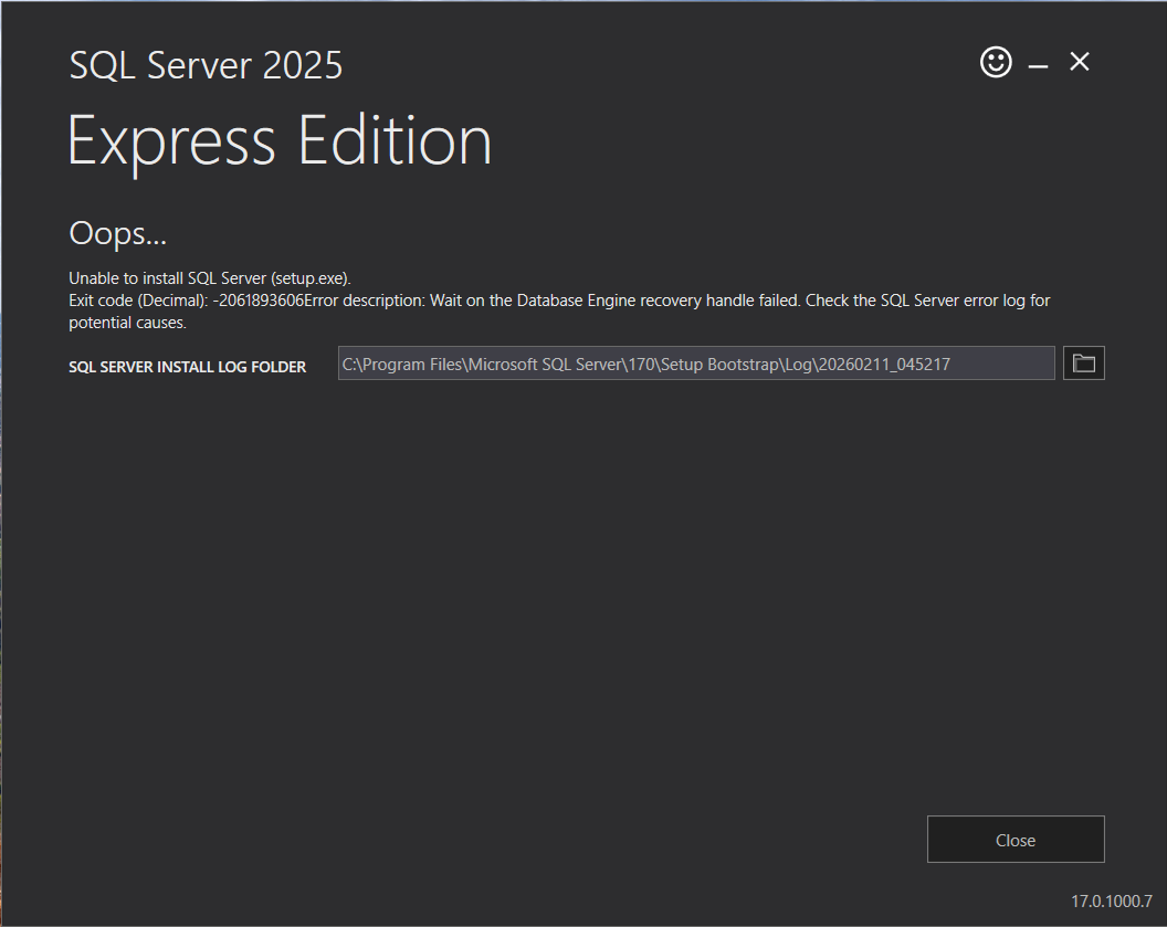

Dear Sir/Madam,
I am facing an error every time I try to install SQL Server 2022 as well as SQL Server 2025 on my laptop.
I have already formatted my system, but the issue still persists. The same error occurs during each installation attempt.
I have attached a screenshot of the error message for your reference. Kindly help me resolve this issue.

The message Wait on the Database Engine recovery handle failed is a generic error that means that SQL Server did not start when Setup wanted to run configuration steps. To understand why it did not start, you need to look in the SQL Server errorlog, which you find in C:\Program Files\Microsoft SQL Server\MSSQL16.SQLEXPRESS\MSSQL\LOG\ERRORLOG. (For SQL 2022. For SQL2025, change 16 to 17.)
If you see a message about 256 misaligned reads, you are running into a known issue where Windows 11 for some disk drives reports a sector size that SQL Server does not cope with. Microsoft has published an article with workarounds for the problem.
If you don't see the message about misaligned reads, feel free to upload the errorlog here, so we can look at it. You will need to rename to ERRORLOG.txt for the forum software to accept it.

  1. Bruce (SqlWork.com) 84,501 Reputation points
    2026-02-11T16:08:15.7366667+00:00
    The error code is not useful. Instead open the log file in folder specified in the error message and look for the actual error. You can report it here for more help.
    the two most common errors are disk sector size or trying to install on an arm processor pc.

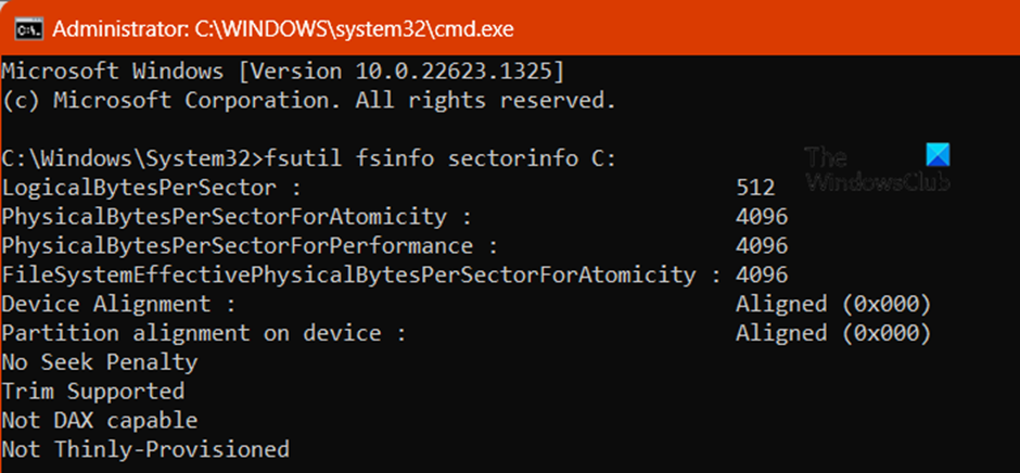

    3) Make changes to the sector size of the drive
    The SQL server installation is influenced by the potential impact of the disk sector size. SQL Server is compatible with 4 KB of sector size, which is represented by 4096, if the size is any different, it will not be compatible.
    Let’s check the sector size of the drive:
    Press the Windows + X key and select Terminal (Admin) or open Command Prompt as administrator.
    Enter the following command and make sure to replace the C drive if you are installing the SQL server in other drives.
    fsutil fsinfo sectorinfo C:
    Find out the PhysicalBytesPerSectorForAtomicity and PhysicalBytesPerSectorForPerformance values.
    Old hard drives often use a 512-byte sector size, while newer Advanced Format (AF) drives typically use a 4K (4096-byte) sector size. If the values are different here, then you should locate the one that has a higher value. If the sector size value is higher than 4096 then it needs some changes in the registry.
    Open the Command Prompt as administrator.
    Enter the following command to add the key:
    REG ADD "HKLM\SYSTEM\CurrentControlSet\Services\stornvme\Parameters\Device" /v "ForcedPhysicalSectorSizeInBytes" /t REG_MULTI_SZ /d "* 4095" /f
    Run the following command to confirm if the key is added successfully:
    REG QUERY "HKLM\SYSTEM\CurrentControlSet\Services\stornvme\Parameters\Device" /v "ForcedPhysicalSectorSizeInBytes"
    Now make sure the disk sector size is not higher than 4096.
    Enter the following command:
    This command will display information about the sectors per cluster on the specified drive.
    Finally, check if the issue is resolved.
