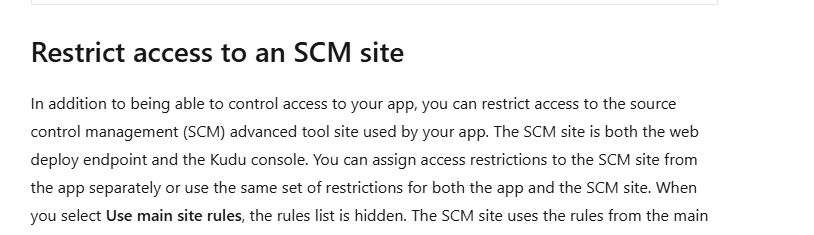

    1. Access Restrictions (most common cause) Go to your App Service > Networking > Access Restrictions. Make sure the SCM endpoint (*.scm.azurewebsites.net) is not blocked. Often the SCM site needs broader access than the main site. > Uncheck “Same restrictions as main site” and ensure there’s an Allow rule for the SCM site.

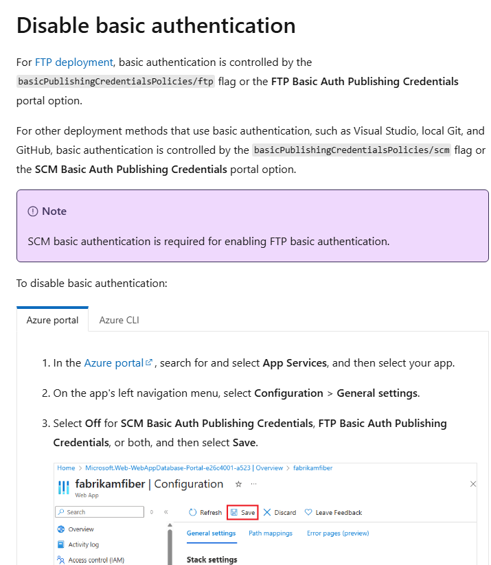

    3. Enable SCM Basic Authentication Go to Configuration >General settings and set SCM Basic Auth Publishing Credentials to On. Save the change, then go back to Deployment Center and save the settings again to refresh the webhook.
