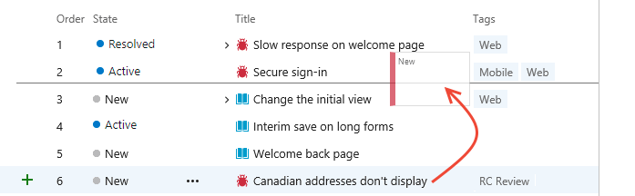

Prioritize your product backlog
If your team follows Agile or Scrum methods, they'll want to prioritize the backlog to make sure that the most important work to complete is situated at the top of the backlog. To prioritize a backlog, follow these steps.
  1. Select the backlog level you want to prioritize.
  2. Turn the Parents view option Off.
  3. Drag the work items up or down within the backlog. Or, if you prefer to use the keyboard, hold down the Alt key and use the up and down arrows.
    Screenshot showing Reorder work items.
