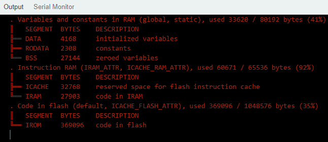

    I would like to know if you can verify the code successfully using Arduino IDE without any errors. This will indicate if the code has any missing dependencies. If the code compiles without any issues, you will see an output similar to below in the output monitor of the Arduino IDE.
