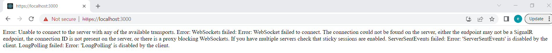

I am using APIM as a reverse proxy in front of Azure SignalR service.

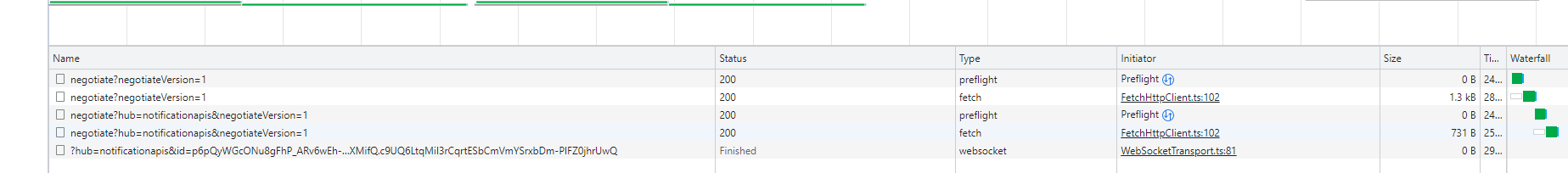

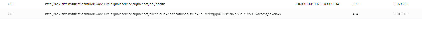

Everything looks good. The negotiate is successful and when it goes to the wss: API to build the connection it failed sometimes due to the handshake API return a 404 on signalR side. I can see that request on the SignalR live trace tool, it means the APIM does forward the handshake to signalR service, however sometimes it returns 404 instead of 101. Sometimes it works sometimes it doesn't. Any ideal why? The access_token is the same since I am using the same user to test it.

    Typically, on ASP.net core, when using WebSockets and skipNegotiation = true
    Please check these to isolate the issue:
    • When using multiple servers without sticky sessions, the connection can start on one server and then switch to another server. The other server is not aware of the previous connection.
    • Verify the client is connecting to the correct endpoint. For example, the server is hosted at http://127.0.0.1:5000/hub/myHub and client is trying to connect to http://127.0.0.1:5000/myHub.
    • If the connection uses the ID and takes too long to send a request to the server after the negotiate, the server:
      - Deletes the ID.
      - Returns a 404.
