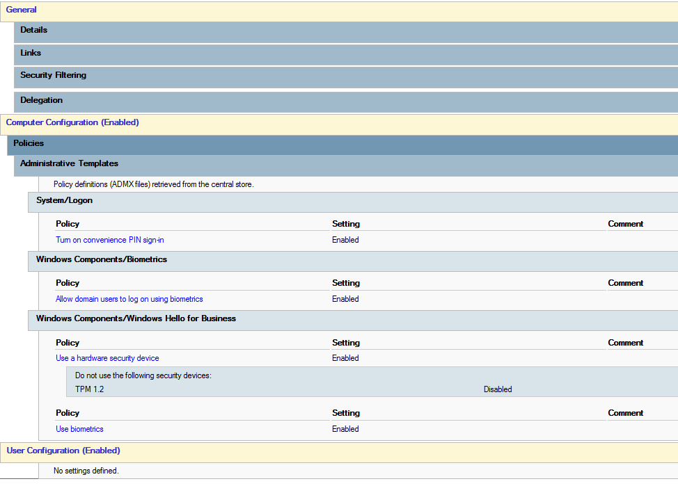

I've pushed a GPO to a testing group enabling biometric login to Windows. You can find the settings below. The policy itself works, but every time the computer restarts or after about an hour, the fingerprint/PIN removes itself. If I turn off wifi and unplug ethernet cable, I don't have the issue as long as I don't connect to the network.

I've compared all policies being pushed, but they are all the same and just mapping drives and installing printers. I have a feeling it's some corruption with my Windows profile but the bigger issue is that everyone I've tried the policy with is experiencing the same issue with their profile on their pc, leading me to believe something has been pushed in the past that's now giving issues with biometrics and I'm really not feeling like giving 300+ users a new Windows profile...
Did anyone have this issue before or does anyone know what's being kept in the user's profile for biometrics so I might be able to try to reset that first? I've done most Windows Hello troubleshooting steps I could find online including resetting the C:\Windows\System32\WinBioDatabase without any luck.
