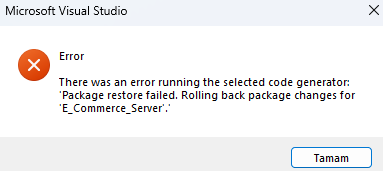

Hello,
I'm working on a project using .NET Core 7 and encountering an issue when running Scaffold-DbContext with Entity Framework 7.0.14. The error message I'm getting is "there was an error running the selected code generator package restore failed rolling back package chanse for." I'm seeking guidance on resolving this issue in the context of .NET Core 7.

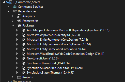

Versions I'm using:
  • .NET Core 7
  • Entity Framework 7.0.14

I attempted to generate a DbContext using Scaffold-DbContext in Entity Framework Core 7.0.14 within my .NET Core 7 project. I expected the command to execute successfully and create the necessary DbContext based on my database schema. However, during the process, I encountered an error
There was an error running the selected code generator package restore failed rolling back package change for
Despite multiple attempts, I couldn't resolve this issue. Seeking advice on resolving this error in the context of .NET Core 7 and Entity Framework Core 7.0.14Ekran görüntüsü 2023-12-19 193512

  1. UMUT CAN 5 Reputation points
    2023-12-20T08:57:14.0666667+00:00
    There is no version 7.0.14. I updated the others to 7.0.11, but it still didn't work. But when I upgraded my project to .net 8, it worked but I started getting other errors. I need to make the project with .net7Ekran görüntüsü 2023-12-20 115429

  4. Hoang Anh Vu 5 Reputation points
    2024-03-19T02:31:34.14+00:00
    I have resolved it by using .NET CLI described in the document. https://learn.microsoft.com/en-us/aspnet/core/security/authentication/scaffold-identity?view=aspnetcore-6.0&tabs=netcore-cli#scaffold-identity-into-a-razor-project-without-existing-authorization-1
    For example, I'm using an existing db context
    dotnet aspnet-codegenerator identity --dbContext MyDbContext
    Please be noted that the target framework and version of all packages should be the same (6.x/7.x/8.x)
  5. Ian Hewitt 0 Reputation points
    2024-05-01T12:35:50.3466667+00:00
    I'm using VS2022 (17.9.6) and just had the same issue.
    I updated the NuGet packages.
    I cleaned the solution
    I cleaned the project
    I did a rebuilt on the solution and how it's working again. Hope this might help someone else in future as all other solutions I tried didn't work for me
