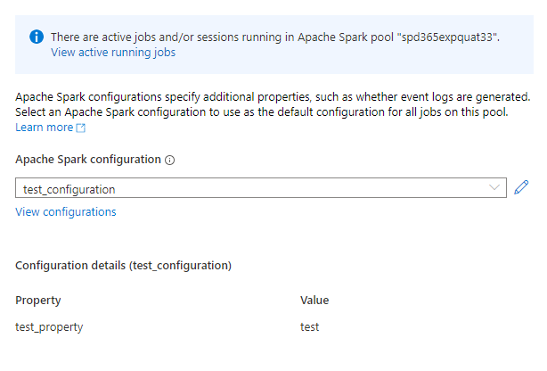

I'm currently working with azure synapse analytics, I created custom properties on my apache spark pool,
as you can see in the first image:
As you can see there is a custom property called "test_property".
My question is "How can I access this property by code?"

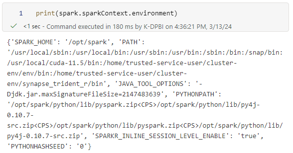

Right now I'm trying to do it like this:
But as you can see there is no "test_property"

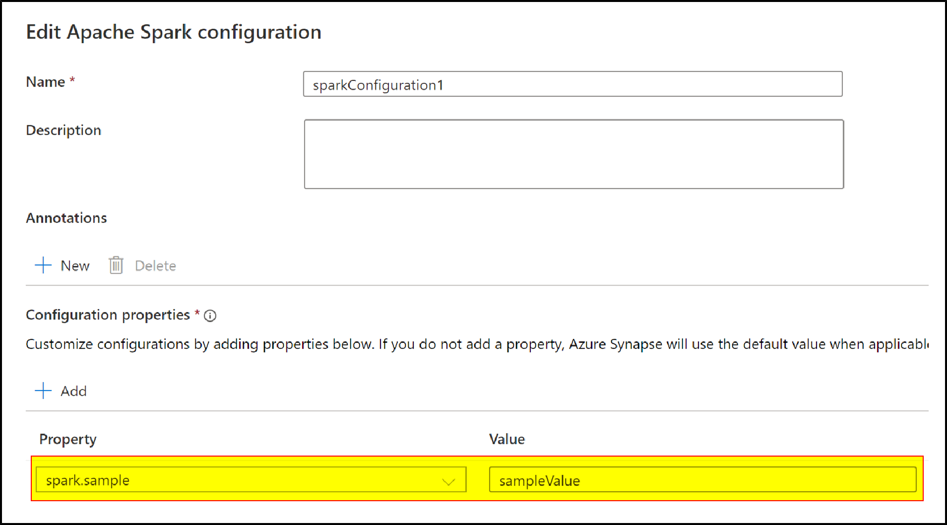

    From the description I see add the prefix sparkis missing, that could be the reason for not getting the custom properties.
    For adding custom properties in Synaspe you would need to add the prefix spark.<custom_property_name> User's image
    Note: Make sure you have attached your spark configuration to the Spark pool and have published the changes.
    After publishing the changes, when you start a new spark session you could run spark.conf.get(<property_name>) to get the value.
