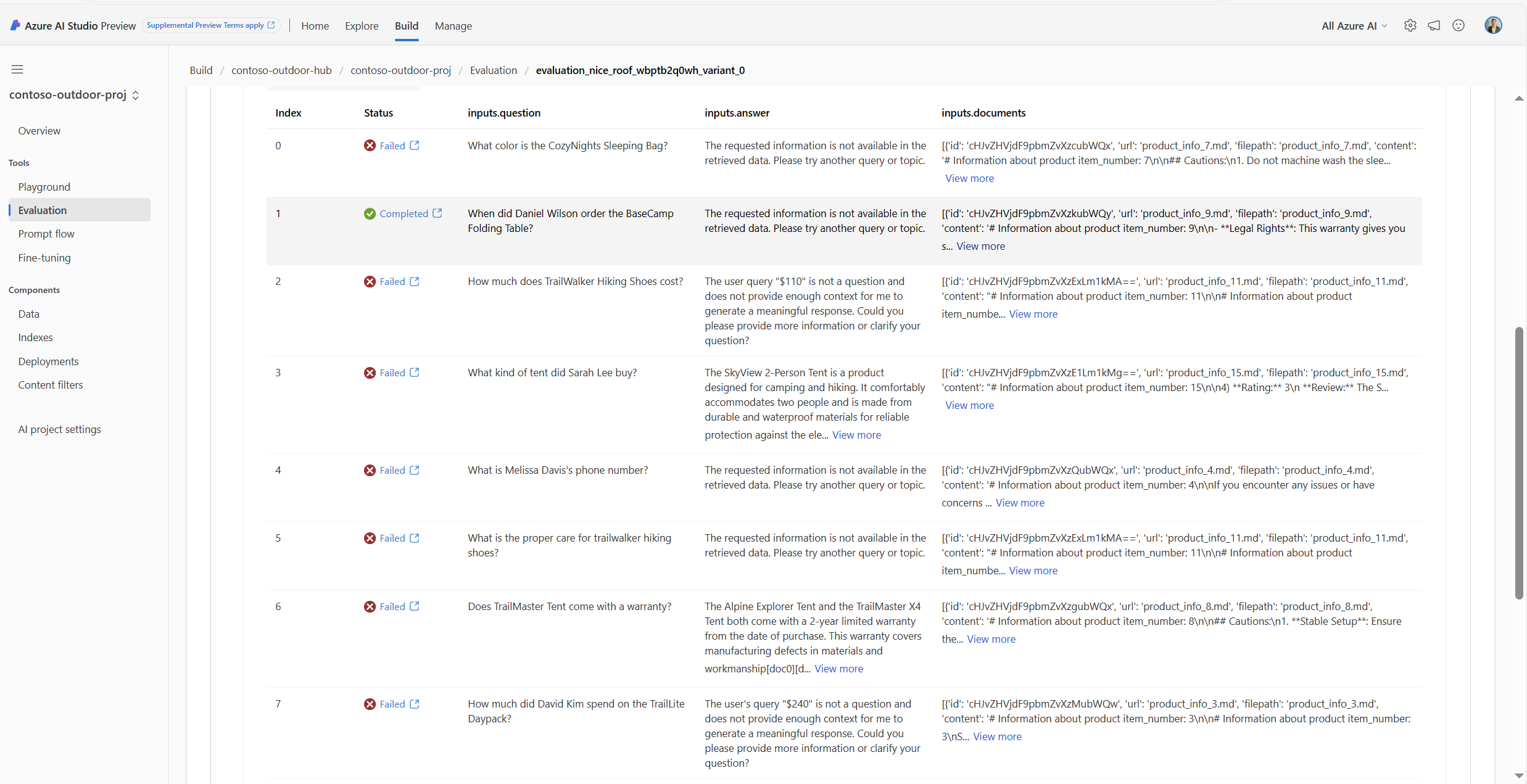

I have been getting failed results across the board:

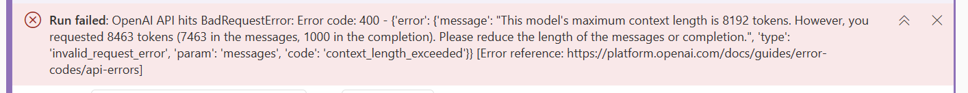

After going through each failed status, I can see that this is the main issue:
How can I resolve this? Is there a way to increase the model's context length?

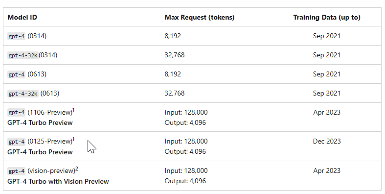

    @Ziggy Zulueta The limits in this case cannot be increased unless you use a model that has higher limits. See the table on this page. Posting the same here for reference.

    The error message you're encountering indicates that the content length of your input exceeds the maximum allowed length for the model you're using in Azure AI Studio., based on your provided information.
    To resolve this, you need to reduce the length of the input provided to the model.
