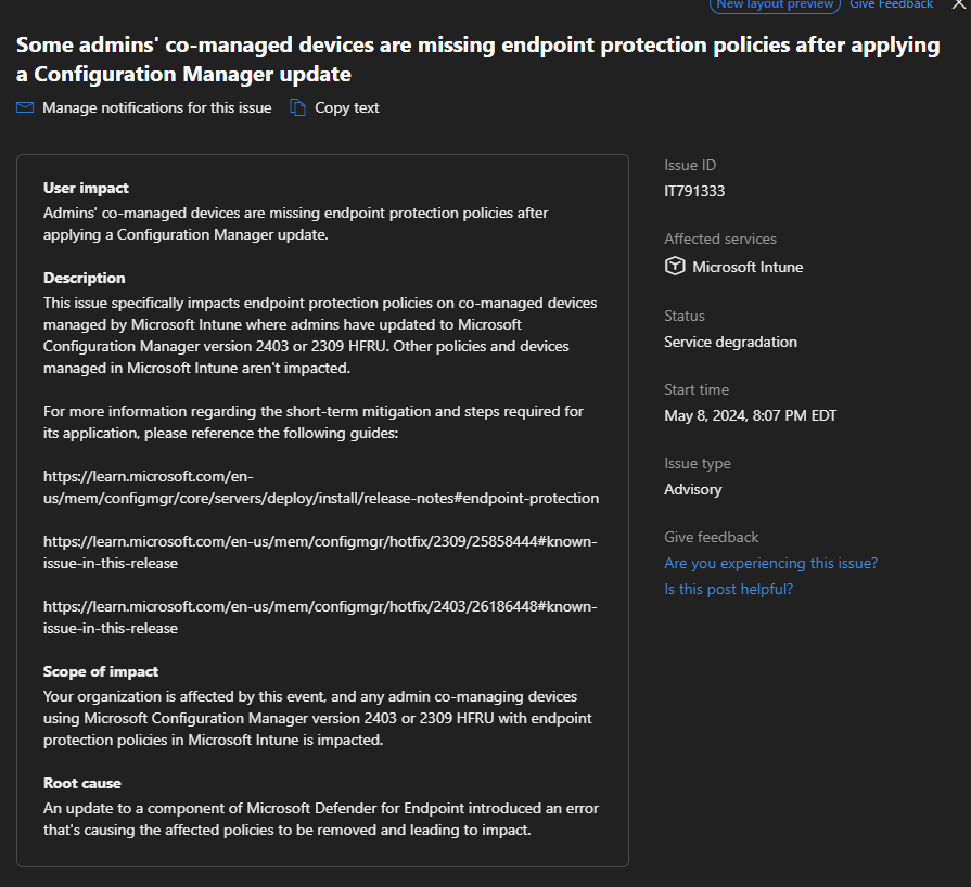

  1. Anthony Meluso 31 Reputation points
    2024-05-10T13:23:01.72+00:00
    The Intune support team tried to get the Config Manager team to pick up the ticket, but they refused. I did notice this advisory in the admin console yesterday. Not sure if it's related.
    Some admins' co-managed devices are missing endpoint protection policies after applying a Configuration Manager update - IT791333
    This issue specifically impacts endpoint protection policies on co-managed devices managed by Microsoft Intune where admins have updated to Microsoft Configuration Manager version 2403 or 2309 HFRU. Other policies and devices managed in Microsoft Intune aren't impacted.
    Our fix has completed the initial validation stages and we're deploying it to our internal test environment for further validation. Additionally, we've identified a short-term mitigation which should provide relief until our long-term fix is in place and included the information regarding this short-term mitigation in our "More info" section. We expect that our fix will begin deployment to your environment on Monday, May 13, 2024, and should complete and resolve the issue on Friday, May 17, 2024.
    https://learn.microsoft.com/en-us/mem/configmgr/core/servers/deploy/install/release-notes#endpoint-protection

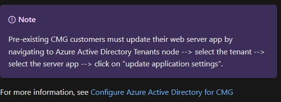

  3. JD (COM) 5 Reputation points
    2024-04-09T21:51:24.64+00:00
    I believe I have found the fix; however I will not be able to confirm until 4/11/2024. reason being we are part of a shared tenant we have to request global admin to perform the operations and that can't happen for me till Thursday.
    I was on a support call for a different issue, but they spoke about this issue.
    This is a post upgrade step to KB25858444
    There is no mention of this in the KB release site. here is the link https://learn.microsoft.com/en-us/mem/configmgr/hotfix/2309/25858444
    In this link https://learn.microsoft.com/en-us/mem/configmgr/core/plan-design/changes/whats-new-in-version-2309 scroll down to cloud-attached management and read the note User's image
    The note is misleading in that not only does this need to happen when you have a CMG but if you have co-management or cloud attach where you created a web (server) app you need to elevate to global admin and navigate to the location in the note right click on the web server app and update application settings which should fix the issue.
    If someone can verify that would be great otherwise I will post on 4/11/2024 once I have completed with the correct permissions.
