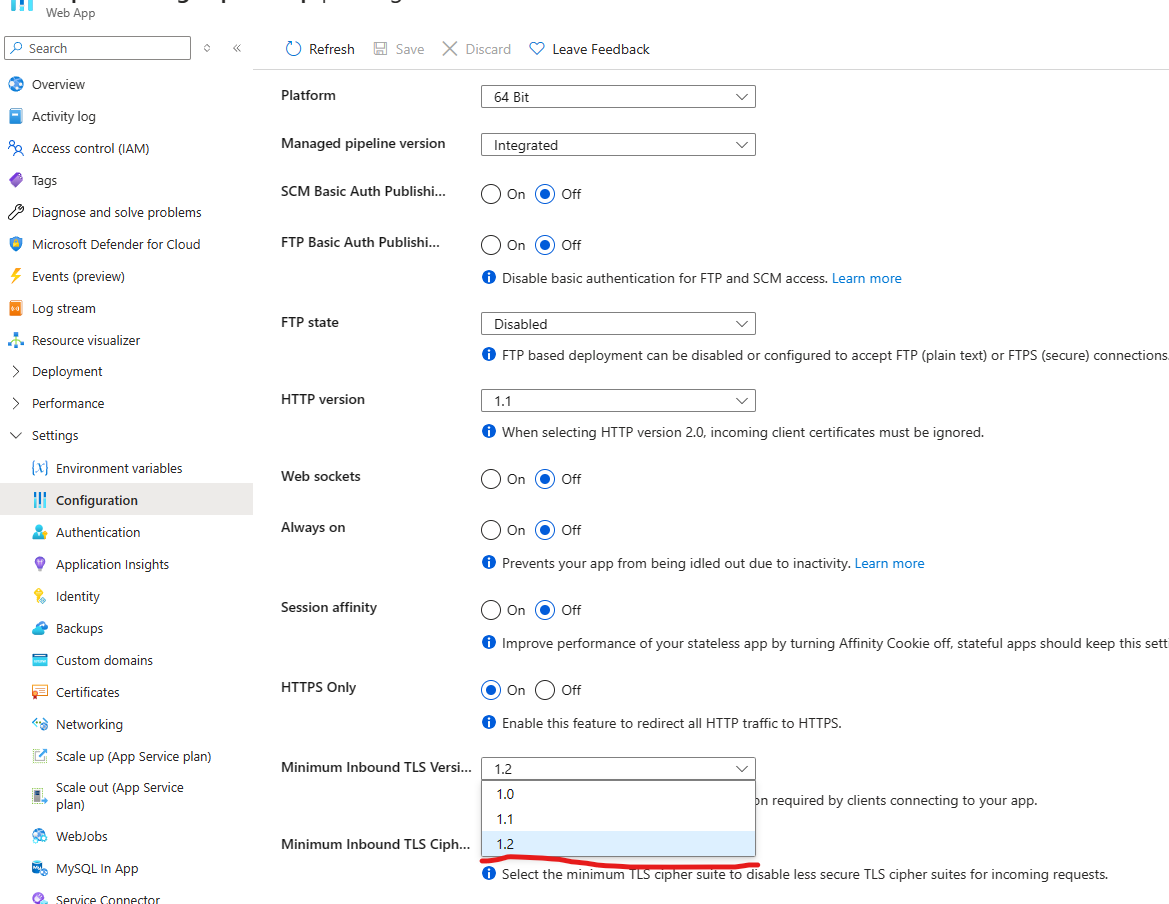

Does Azure's app service currently support setting the minimum TLS version to 1.3? Why didn't I find the option for 1.3?

Does Azure's app service currently support setting the minimum TLS version to 1.3? Why didn't I find the option for 1.3?User's image

    @Zhuo Chen , As TP (thank you) highlighted, currently, you need to use CLI/PowerShell method to set TLS version to 1.3. The portal drop-down option to set 1.3 version will be enabled in a few months*, we do not have an exact ETA to share.
    Note: the timeline is just an estimate, it may change depending on the myriad factors.

    You can't set it via the portal, but you can using powershell commands, see sample below:
    $webapp = Get-AzWebApp -Name myWebApp -ResourceGroupName myResourceGroup
    $webapp.SiteConfig.minTlsVersion = 1.3
    $webapp|Set-AzWebApp
    After making the change you may verify minimum TLS using below:
    https://www.ssllabs.com/ssltest/analyze.html
