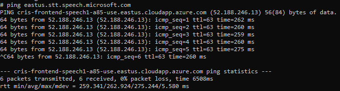

Below is the container details:
Can someone please help?
