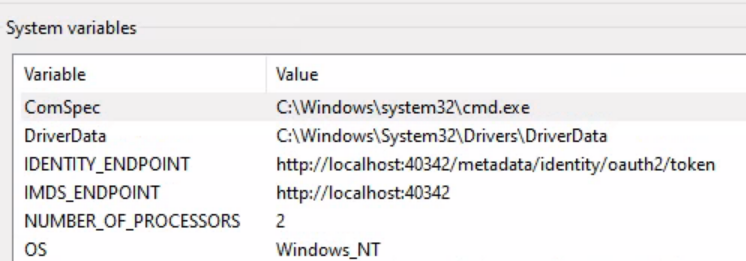

I have the correct environment variables, and am able to get a token manually through PowerShell:
