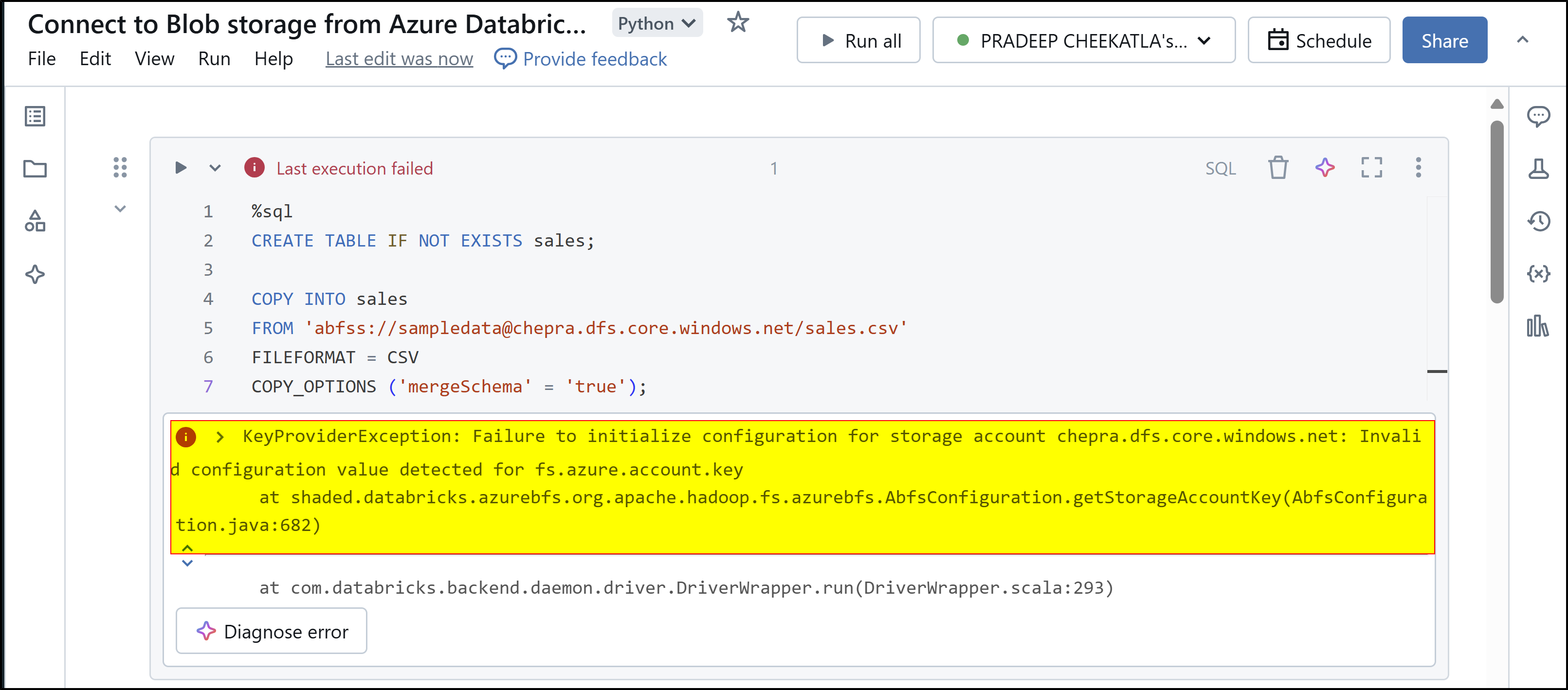

So I would like to read a table from a CSV file on Azure Blob Storage in my own account, and load it into a table in Unity Catalog on databricks (hopefully using SQL).
I have tried this SQL command:
CREATE TABLE IF NOT EXISTS <table_name>;
COPY INTO <table_name>
FROM 'abfss://<container>@<storage_account>.dfs.core.windows.net/<filename>.csv'
FILEFORMAT = CSV
COPY_OPTIONS ('mergeSchema' = 'true');
But it gives me the following error:
Failure to initialize configuration for storage account <storage_account>.dfs.core.windows.net: Invalid configuration value detected for fs.azure.account.key
I ideally don't want to use an access token, but a role if possible (or short lived credentials) for authentication, but have no idea why this doesn't work.

    This is excepted when you haven't used any credentials to access the Azure Data Lake Storage Gen2 account where you have the sample data.

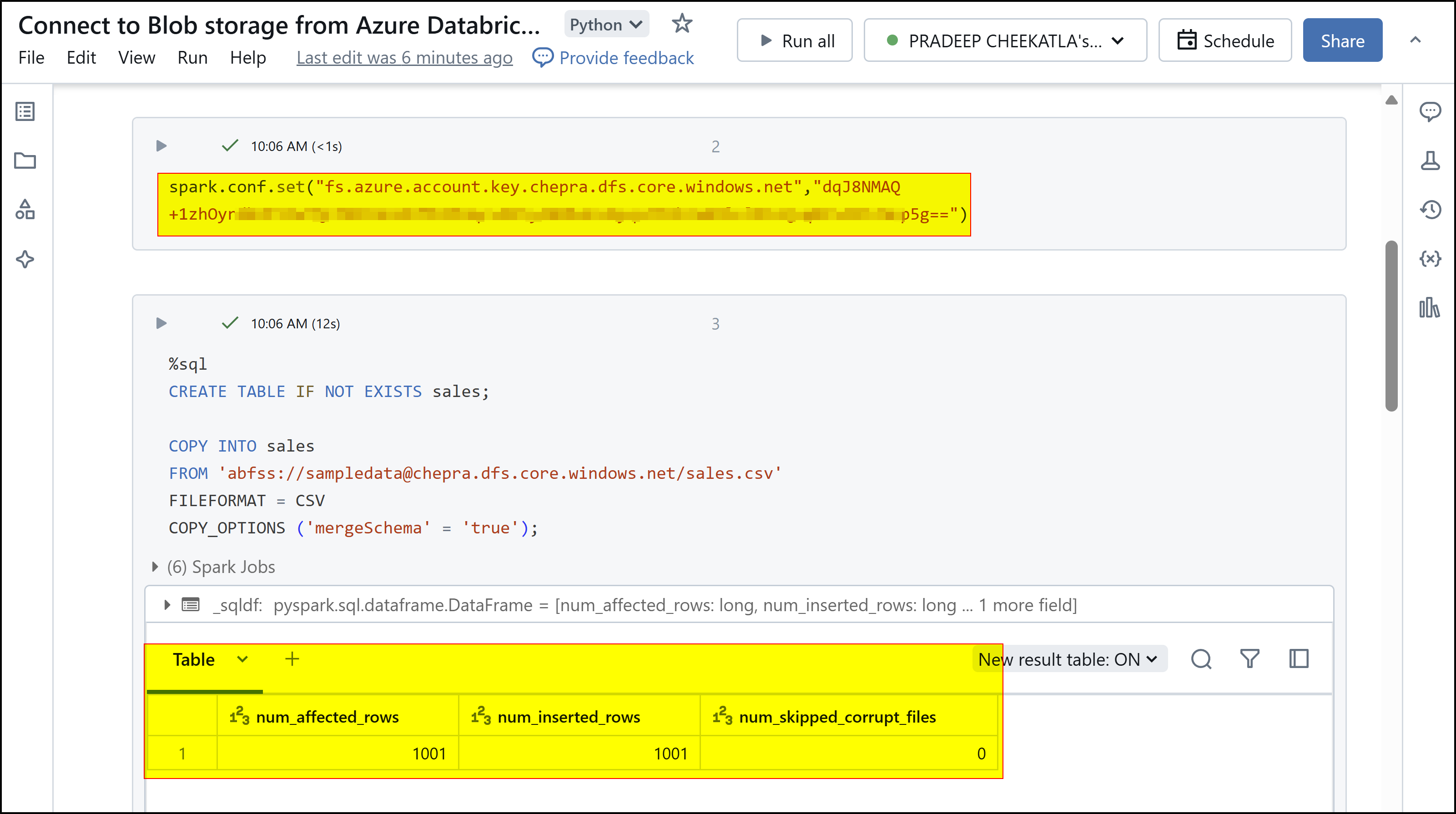

    According to the document: Connect to Azure Data Lake Storage Gen2 and Blob Storage - The following credentials can be used to access Azure Data Lake Storage Gen2 or Blob Storage:
    • OAuth 2.0 with a Microsoft Entra ID service principal
    • Shared access signatures (SAS)
    • Account keys
    For the demo purpose, I had used Account keys option to just to show case the authentication can be used to access Azure Data Lake Storage Gen2.
    spark.conf.set(
        "fs.azure.account.key.<storage-account>.dfs.core.windows.net","<storage-account-access-key>")

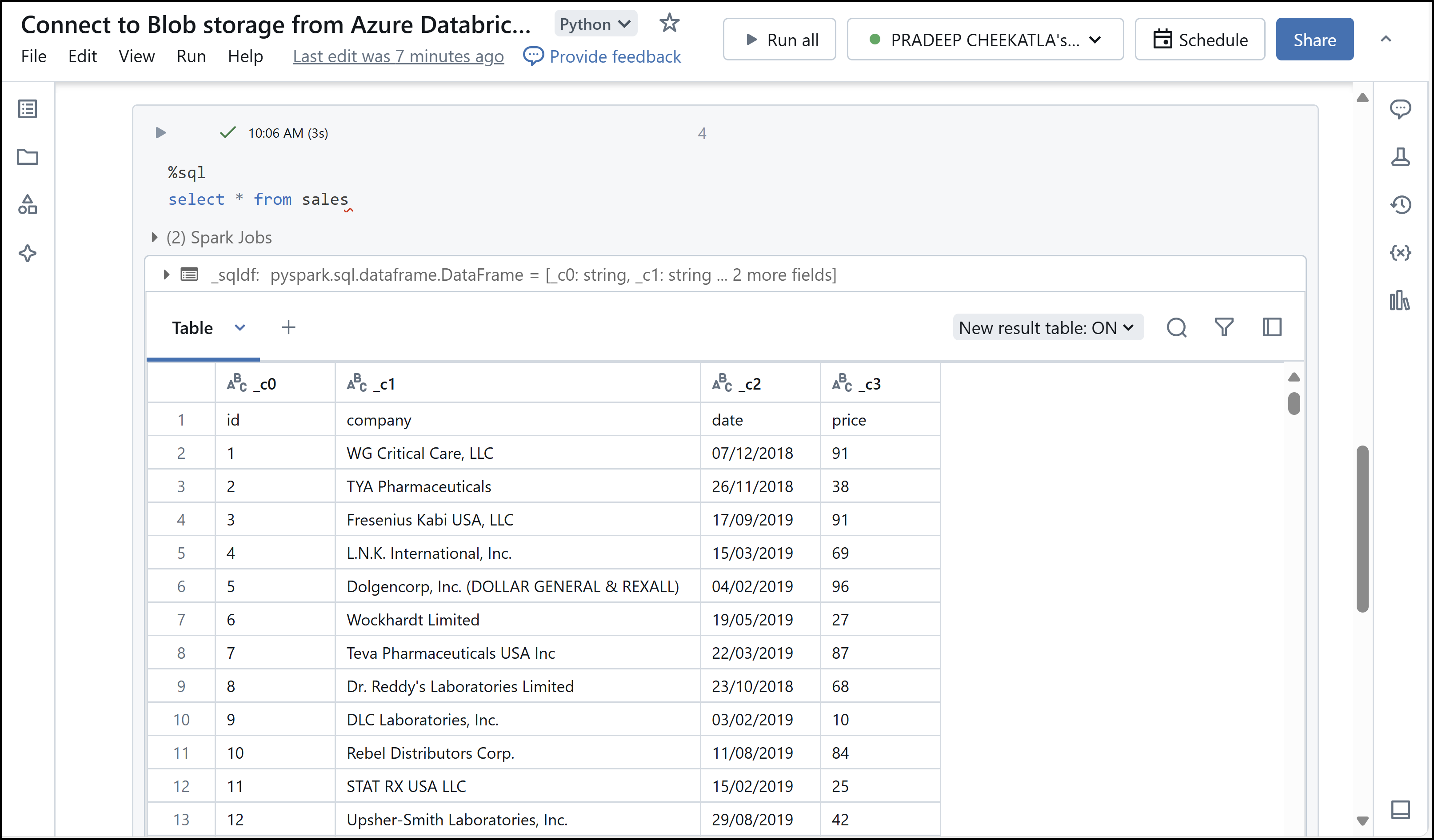

    Checking to see if the sales table has been created.
