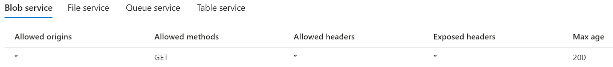

I am trying to serve a GeoTIFF in a container, but am reciving a status code: 403 Server failed to authenticate the request. Make sure the value of Authorization header is formed correctly including the signature.
Looking around online, I noticed I need to configure my CORS which I have done using the following parameters: User's image
From there, I navigated to the GeoTIFF, select it then open the "Generate SAS" tab. I select all permissions, keep the default times (which match the clock on my development machine), and use HTTPS only.
I add my URL string with SAS token to my JavaScript within my HTML file, but it never renders. I've checked my JS and HTML code using example GeoTIFFs from GitHub which have all rendered as expected.
I am uncertain what else I need to do to serve out these images. Does anyone have any ideas?

    • Since you’ve already configured CORS, double-check that the settings are correct and that the allowed origins, methods, and headers are properly set up.
    • If your storage account has firewall rules enabled, make sure that your client IP address is allowed. This can sometimes cause authentication issues.
    • Make sure your CORS settings allow requests from your development environment. This includes allowing the necessary HTTP methods (GET, POST, etc.) and headers.
