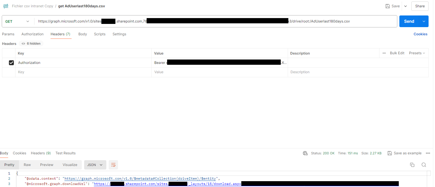

I created an application on SharePoint and gave it the necessary permissions to access a .csv file stored on my SharePoint.
With Postman, I can access the file using the access token I generated :
but with JavaScript, I get a error :
Here is my code:
Can you please help me solve the problem?
