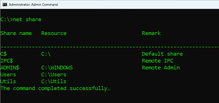

  1. MotoX80 36,291 Reputation points
    2024-08-28T12:16:51.6566667+00:00
    On the server, open an admin command prompt and run "net share" to see if those shares exist or not.
    Check the registry key listed in this article to see if someone disabled the admin shares.
    https://learn.microsoft.com/en-us/troubleshoot/windows-server/networking/remove-administrative-shares
    If the shares exist, then using an admin account on some other pc, use Powershell to test to see if you can access them.
    Get-ChildItem -Path  '\\servername\c$'
    If that fails, test to see if the firewall is blocking access to port 445.
    Test-NetConnection -ComputerName servername -CommonTCPPort SMB
    If everything works ok, then it would appear that Nessus is not using an administrator account to authenticate to the server. Check the security eventlog on the server for logon failures when you run a scan. Refer to the Nessus documentation as to how to configure it for scanning.

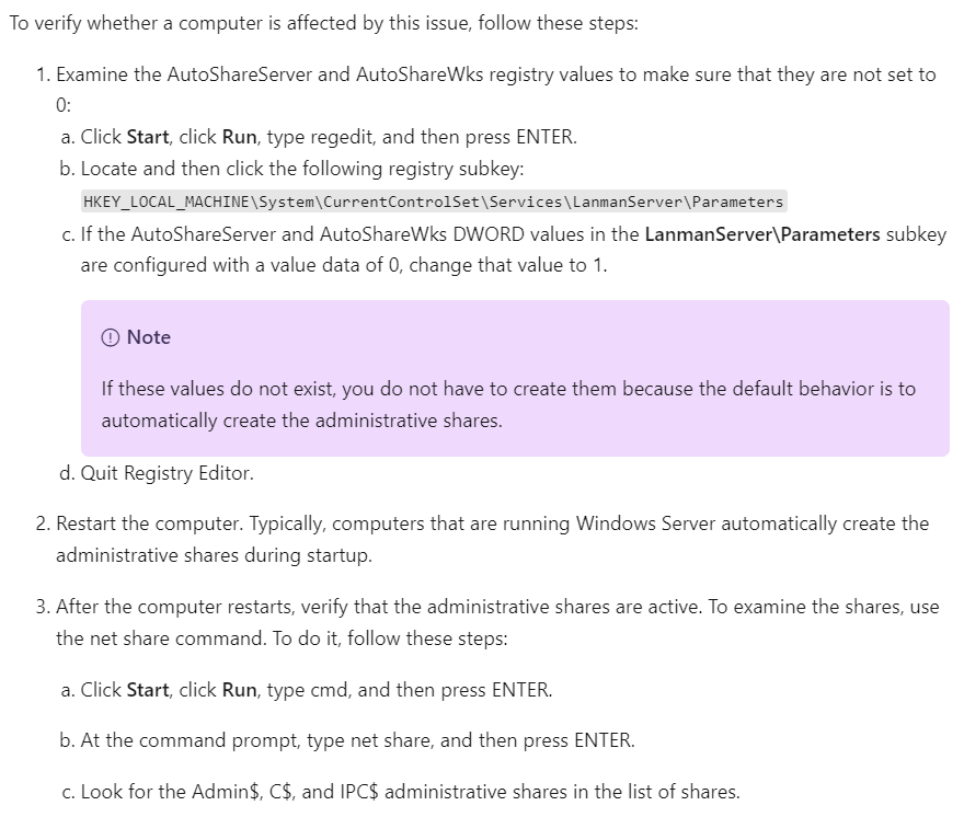

    Hello,
    Thank you for posting in Q&A forum.
    Based on your needs, I recommend you refer to the following link to enable administrative sharing by modifying the registry.
    https://learn.microsoft.com/en-us/troubleshoot/windows-server/networking/problems-administrative-shares-missing
    Note If you modify the registry incorrectly, you can cause serious problems. Therefore, follow these steps carefully. For additional protection, back up the registry before you modify it. For more information about how to back up and restore the registry, see How to back up and restore the registry in Windows.
    I hope the information above is helpful.
