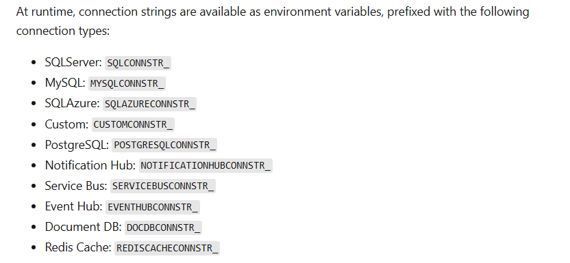

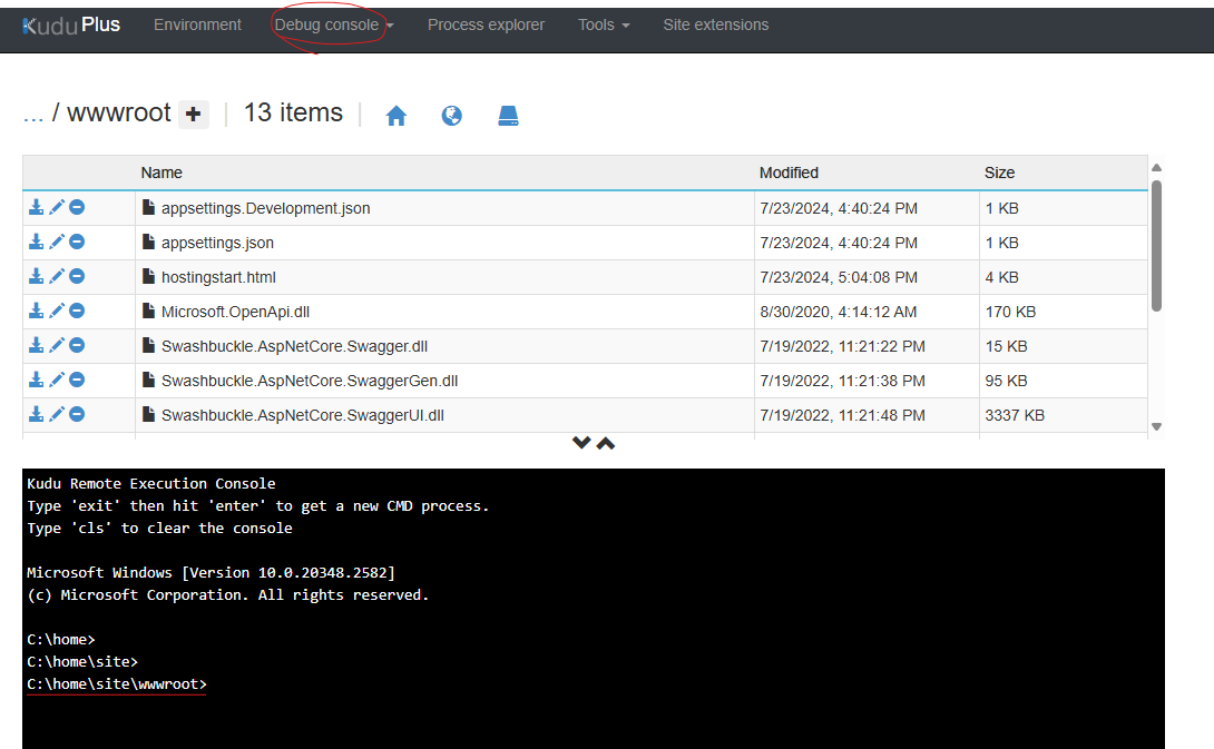

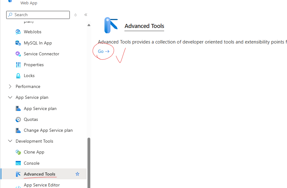

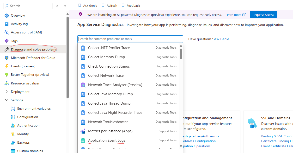

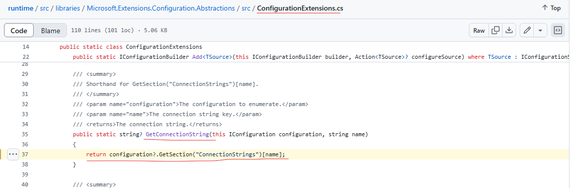

    Hi @Nils Bezjak,
    Reading the connection string in the asp.net core project is done using the following code.
    builder.Configuration.GetConnectionString("AZURE_SQL");
    Source Code
    Suggestion
    Since we are using Azure Web App, it is recommend to use connection string feature like below. Here is the official link: Configure connection strings.
