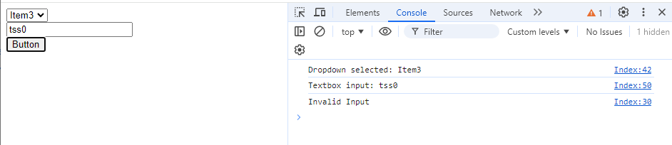

    Here is a simple test:

    Result:

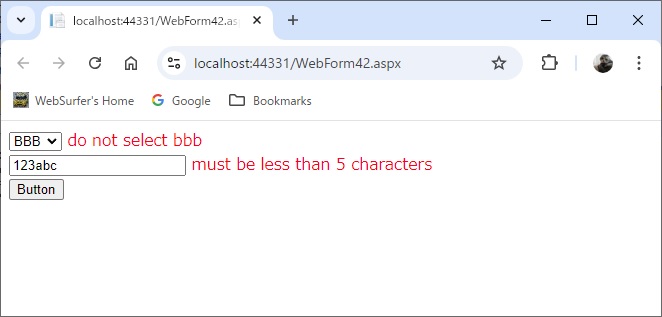

    Result
    enter image description here
