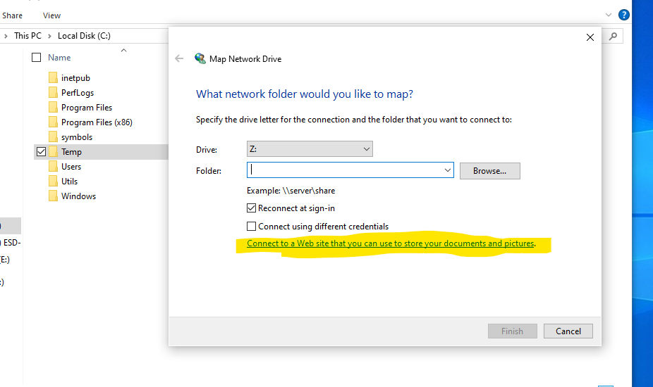

  4. Jeffrey Grammer 0 Reputation points
    2024-09-27T01:49:10.8166667+00:00
    I did try that, and it also failed.
    System error 67 has occurred. The network name cannot be found.
    I am normally the one that people call for help. This issue has me stumped

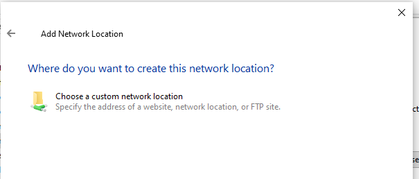

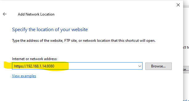

    Here is a video that makes it look so easy. The narrator on the video explained the process extremely slow, but it works for him on win 10. To see the successful mapping go to minute about minute 13:37 on this video https://youtu.be/aMBK675WCDQ
    I did notice that you can take a url and put it in the normal "Map Network Drive" and it does the exact same thing as the link "Connect to a Website that you can use to store your documents and pictures." Except when you use the standard mapping process but insert url's (http:// , https://) you get the option to assign a Drive character. (C drive or F drive)
