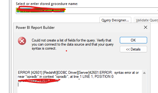

Am trying to call a stored procedure from AWS Redshift DB to Report builder. But not able to execute the stored procedure when i give the procedure name under stored procedure section in report builder.
Let me know how to achieve this.

    SSRS can talk to anything that has a database driver including anything using ODBC. I know nothing about Redshift but a quick scan of their docs indicates that what they call a stored procedure isn't a database sproc as we know it. In order to call their "sproc" you have to use the CALL command.
    Behind the scenes tools like Report Designer rely on the commonly implemented support for getting schema information about a database including tables, columns and stored procedures. If a database provider doesn't implement this, or they don't implement it completely, then tools will be unable to display anything useful about them. That is what I believe is going on here. As such I don't think you're going to be able to use the built in support for sprocs in the designer. Replace your sproc call with the direct query to CALL sproc and ensure you are specifying the parameters. Then see if the call works. You won't get any help from the designer here because it has no schema to bounce off of. You're making an adhoc query. You can still use parameters (I believe) since they are independent of the sproc call but you'll need to pass them as part of your call directly.
