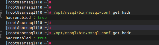

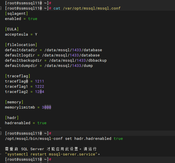

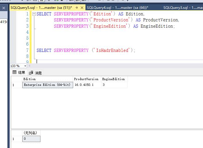

The issue arises when attempting to enable the Always On availability groups feature. After following the official documentation to configure Always On (Enable and Disable Always On Availability Groups), I found that the SELECT SERVERPROPERTY('IsHadrEnabled'); statement consistently returns 0, indicating that the feature is not enabled.

  1. Configure Always On according to the official documentation, enabling hadr.hadrenabled using mssql-conf.
  2. Restart the SQL Server service.
  3. Verify the configuration with /opt/mssql/bin/mssql-conf get hadr.hadr, which shows hadrenabled = true.
  4. Execute SELECT SERVERPROPERTY('IsHadrEnabled');, which still returns 0.

Request for Assistance:
Could the SQL Server team look into this issue and provide a fix or workaround? This bug affects the ability to use Always On availability groups on Linux, potentially impacting users who rely on high availability setups in their production environments.
Thank you for your attention to this matter. I look forward to any guidance or updates you can provide.
