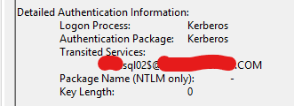

    I've managed to resolve this by swapping from "Use Kerberos only" to "Use any authentication protocol". I don't really understand why it didn't work though, query to SQL says its using Kerberos, eventlog on file server shows Kerberos too - something for another day
