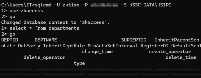

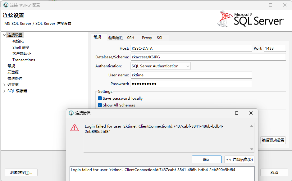

We want to use JDBC to connect Sql server none default instance database, but always got below error:
Login failed for user 'XXX'. ClientConnectionId:92d1a0fb-49c0-45c2-968f-ded3089d6ac9
We make sure the password is correct.
If we try to connect same sqlserver's default instantce database, it's ok.
The Sqlserver's version is 2017, please give us some help, thanks.

    I am not familiar with DBeaver, but your configuration looks wrong. I think Host should be KSSC-DATA\KSPIG. Database should probably be zkaccess only. It would be very odd to specify the instance name with the database rather than with the host.
    Also, try to leave the port blank. If you can't, you will need to look up the port for the KSPIG instance in SQL Server Configuration Manager.
    What is happening now is that you are connecting to the default instance on KSSC-DATA, and apparently, there is no login for zktime on this instance.
