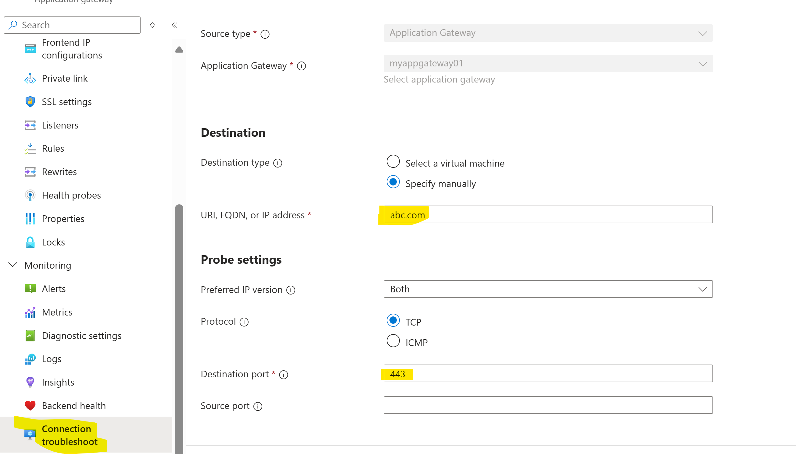

    • Share the output from the connection troubleshoot blade of the application gateway as shown below. Put your URL hostname as it is used on the backend server.

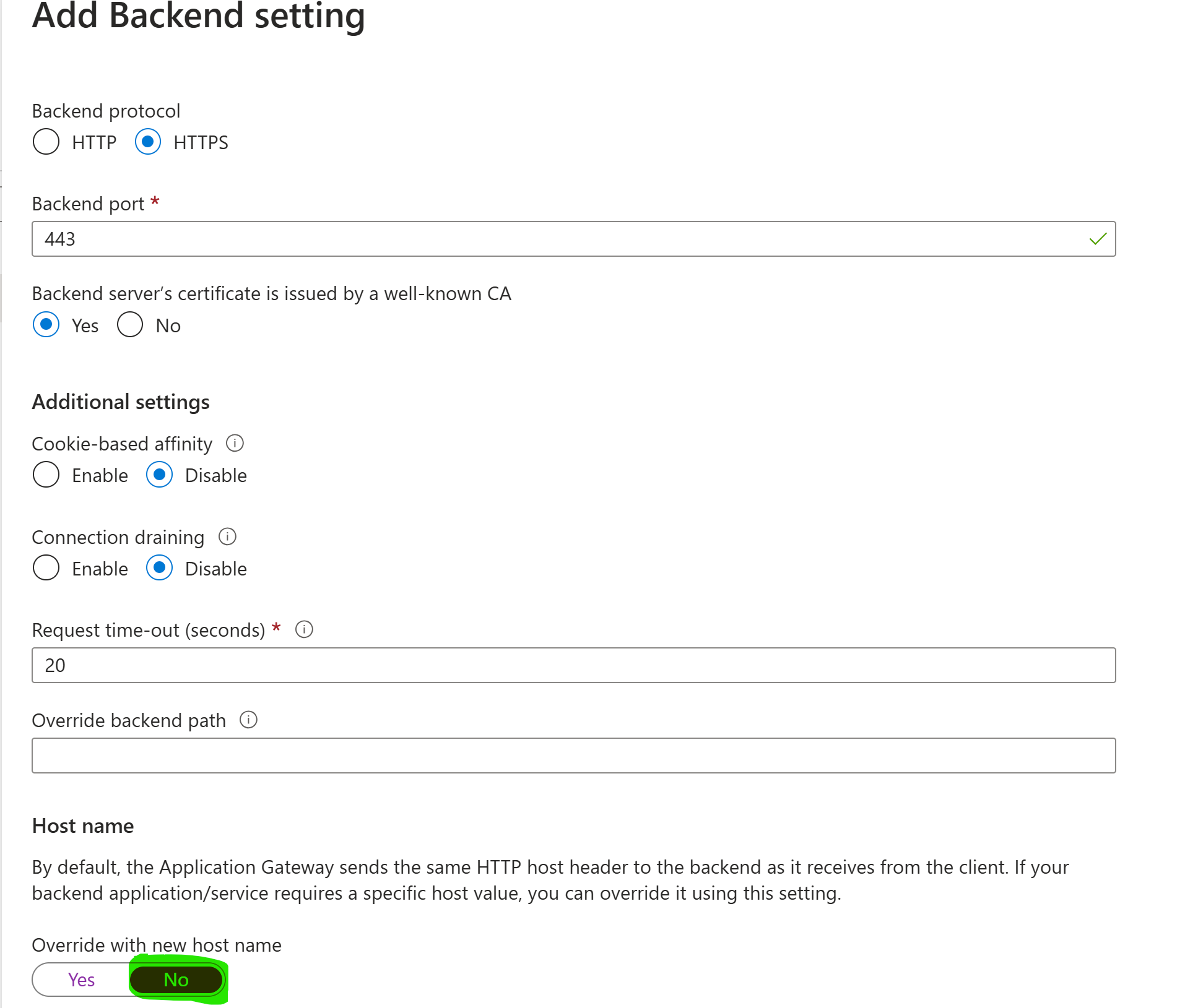

    • User's image
    • Kindly ensure you are using the correct backend setting.
    1. If you are using different hostname on the backend server as compared to the frontend (listener) ensure you have correct settings configured.
    1. Choose no if you backend server is using same hostname as on frontend (Listener) , in short you are not modifying the URL hostname.
    • Ensure you have correct custom health probe configured. If you are using HTTPS probe. Make sure you have a complete chain of the certificate configured on the backend server.
    Ensure you have a page available under Path on your backend server for example i have given path as /index. If you have a page available on hostname leave path blank.
    Choose the correct Backend setting.
