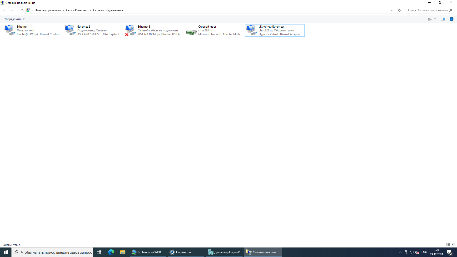

Good health! Please tell me, help pliz:
Given:
The Domain Controller (hereinafter referred to as DC) for Windows Server 2022
the Hyper-V role is installed on the server to create a virtual machine (hereinafter referred to as VM) for the Microsoft Exchange Server mail server, so as not to install it on the DC.
in order to connect client PCs to the domain, a network bridge has been created (shared access to the adapter via the Control Panel)
that is, my IP settings in the VM were like this:
IP: 192.168.3.124
Subnet mask: 255.255.255.0
Main gateway: 192.168.3.1 (router's IP address because the domain controller is connected to the router)
DNS server: 192.168.3.3 (IP of the domain controller)/192.168.137.1 (IP of the network bridge)
I have created an External virtual switch (for receiving emails from the Internet and web access outside the server (from a smartphone, tablet))
Problem: The Hyper-V VM stops detecting the domain controller after each reboot - the domain itself (that is, instead of the domain: chuc228.ru , it shows the Network) and accordingly, the Exchange and Active Directory services on the VM stop working. Only a current reset of the network helps, but not for a long time.
Question: What do I need to do so that at the same time: the VM sees the domain controller and does not lose contact with it, the client PCs are connected to the domain controller via a network bridge and have web access from other devices to Exchange Server resources?
I tried to recreate the virtual switch. Bottom line: it's useless, it doesn't help. Anyway, after a few minutes, hours, the connection with the DC disappears.
I don't know what to do.
I am attaching a screenshot from the Network and Sharing Center.
Application: Screenshot of the Network and Sharing Center on the domain controller

    Hi Пахомов Кирилл Евгеньеви,
    Thanks for your post. From your description, it seems that there is some network connectivity issue in the bridge network. Before moving on, please help clarify that you have configured the right virtual switch with the following steps:

    Also, we have encountered similar issues that is associated with a driver issue. For whatever reason, the version of NIC driver in-use is incompatible with the Hyper-V Extensible Virtual Switch protocol that gets bound to the physical adapter when you associate it with an external vSwitch.
