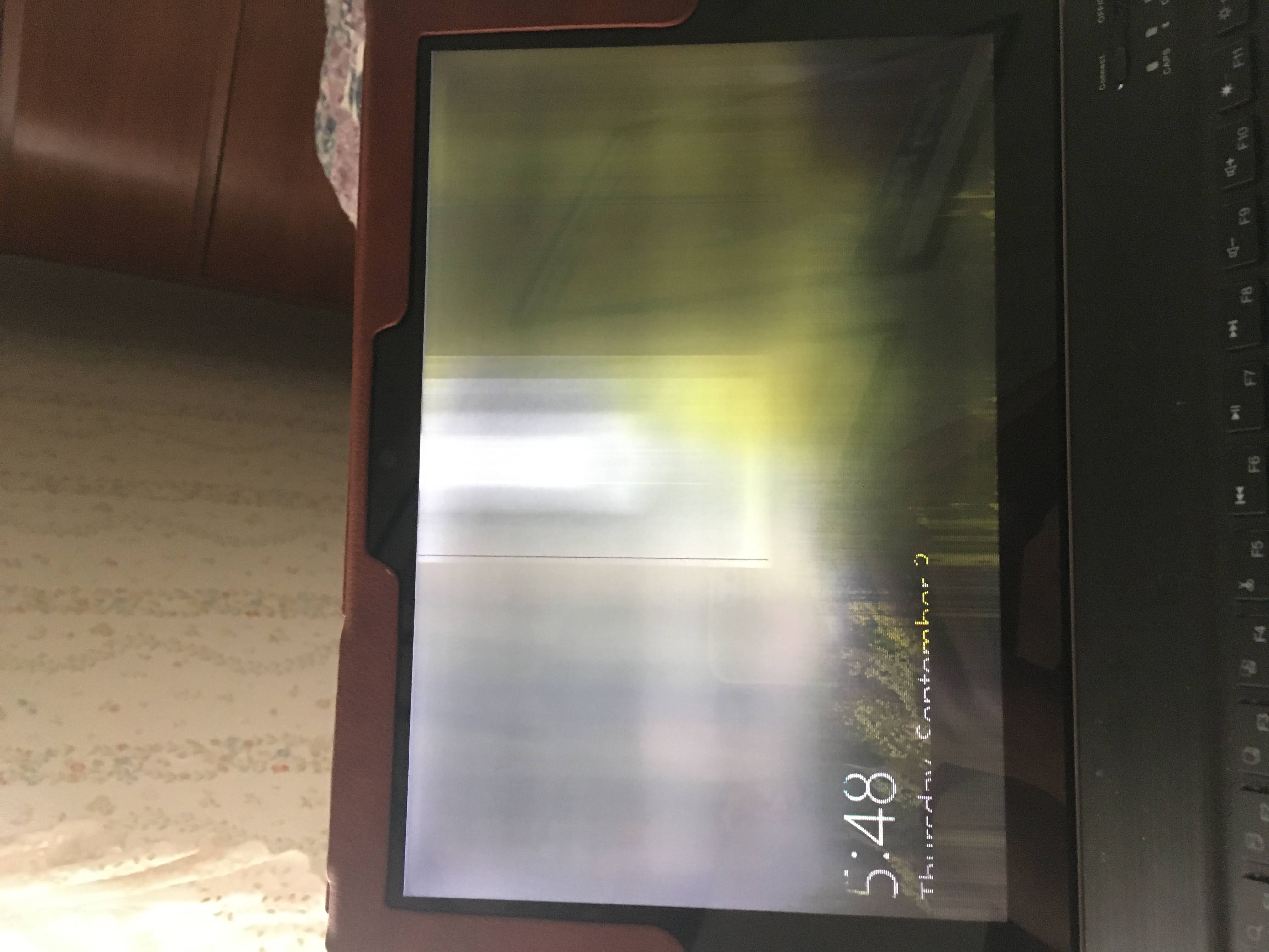

I purchased a new Microsoft Surface Go less than a year ago, and over the course of the past couple months it's started having an issue with the display in which the whole screen turns bright white with vertical lines across it, and some colors from whatever page I'm viewing may be visible through the lines.  This seems to happen shortly after turning the computer on, and so far it's always fixed by restarting it, but I'm concerned that it could become a more persistent issue.  Based on some other questions I've seen it seems like other people have had somewhat similar problems, and that it might be a hardware issue.  Is there anything I can do to try to troubleshoot it, or maybe get an exchange from Microsoft?

    Thank you for the pictures, LoisCR.
    You can basically check this out in UEFI if this display screen issue appears in that environment. If it does, then it's a hardware problem and the best resolution is to send the device for service to have it replaced. To access UEFI, visit this link for details >>https://support.microsoft.com/en-us/help/4023531/surface-how-to-use-surface-uefi.
    To send the device for service, it's best to contact ourMicrosoft Surface Support for further assistance.

    Thank you for your advice, I followed all of your instructions exactly and no corrupt files were found from the system file checker run, the diagnostic toolkit said that I may need to update BitLocker, but upon looking into the issue I found that my Windows 10 Home system doesn't include BitLocker in the first place.  I uninstalled the display driver and restarted the computer, and while restarting, the same display issue appeared again.  I've installed all updates for Windows as well.
    It seems to me that this may be a hardware issue.  I'm including a couple of pictures of the problem.  My device is still under warranty right now, does this look like a hardware problem that I could get an exchange or refund for?
