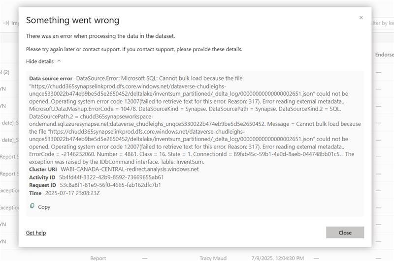

We run power bi reports from D365 F&O using a Synapse Apach Spark Pool. We have had no issues with this method till last week when reports started to fail to refresh sometimes. Error messages on the SQL logs are:
When accessing synapse:
Cannot bulk load because the file "---" could not be opened. Operating system error code 12007(failed to retrieve text for this error. Reason: 317).
When running a query:
Cannot process the file "---" because it could not be opened.
The power bi error is below.
2e3eedcb-618d-4a4d-ab74-9f247006ffe6
Nothing has changed in the way we access or use synapse so why are we experiencing issues now? We have tried to increase to number of cores to medium size but we are still experiencing intermittent failures.

    Based on the error message and execution history you have shared, it appears that the issue is most likely related to intermittent DNS resolution failures when the Synapse Spark pool tries to access Delta files in Azure Data Lake (e.g., _delta_log/*.json). Specifically:
    • The storage account’s public network access is disabled, which is standard for secure environments.
    • However, the private endpoint for the storage account is either misconfigured or not correctly associated with the required Private DNS Zone.
    • This results in the Spark pool being unable to resolve the blob endpoint (e.g., *.blob.core.windows.net), leading to intermittent file access failures.
    Correct configuration required -
    For private endpoint access to function properly, the associated Private DNS Zone must be:
    privatelink.blob.core.windows.net
    This DNS zone must be -
    • Correctly linked to the virtual network used by the Synapse Spark pool.
    • Properly resolving the storage account endpoint (e.g., yourstorageaccount.blob.core.windows.net).
    Here are some troubleshooting steps that might help you:
    Verify Private Endpoint Configuration -
    • Navigate to your Storage Account → Networking → Private endpoint connections.
    • Check that the private endpoint is linked to the correct DNS zone: privatelink.blob.core.windows.net.
    Ensure DNS Zone is Linked to the Spark Pool’s VNet -
    • Go to Private DNS Zones in Azure and verify that the zone is linked to the correct Virtual Network.
    • Ensure the A-record for your storage account exists and resolves properly.
    Optional Test (if needed) - Run this in a Synapse notebook to verify DNS resolution -
    %%sh
    nslookup <yourstorageaccount>.blob.core.windows.net
    Once the private endpoint and DNS configuration are corrected, this should eliminate the DNS-related errors you're seeing (error code 12007).
