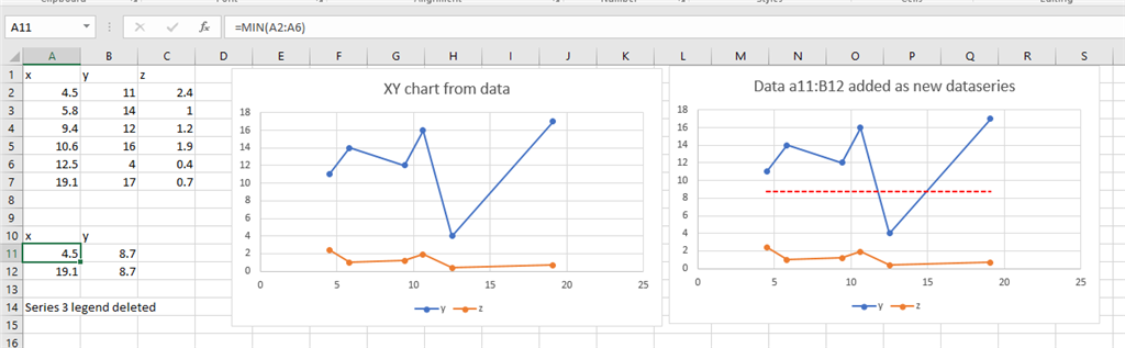

Hello All,
I am trying to add a fixed horizontal line to a scatter plot that will span the entire chart, regardless of x-axis. For this reason the error bar method will not work. It also needs to be dynamic, as the location is subject to change.
Thanks
Jacob

    2017-06-29T22:10:31+00:00
    This may get you on track
    best wishes
    2017-06-29T17:07:09+00:00
    You can still use a separate data series for the horizontal line. It would only require two data points (x1,y1) (x2,y2) connected with a line. Use formulas for the x and y values. For the y values you can use a formula that is based on the other data. You could use a formula for x1 and x2 that calculates the minimum and maximum of all 3 of the other sets of x values.

    2017-06-29T16:53:19+00:00
    Hey Tom
    That wouldn't really work here. I have three different sets of data I am trying to plot on a scatter plot, and each set has differing amount of data. So I need something that will have a horizontal line at a point that can be set, and will move with the data no matter which set has the most points.
    Thanks
    Jacob

    2017-06-29T13:52:42+00:00
    add data as a new series that plots a straight line.
