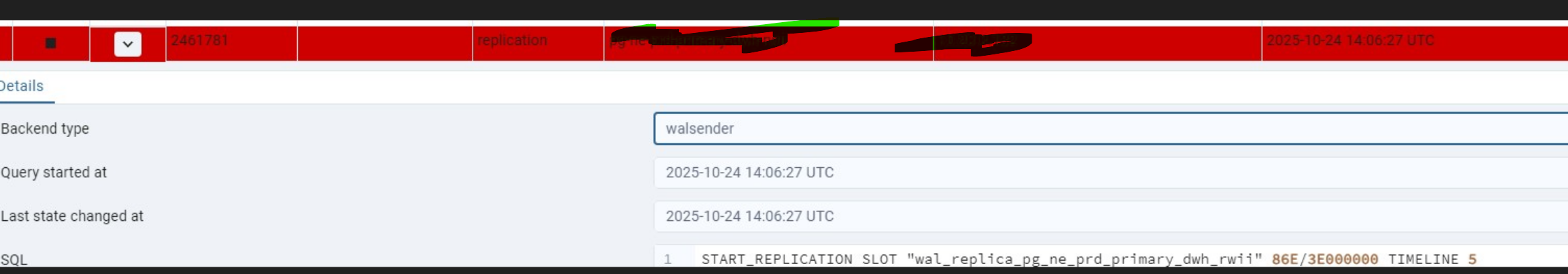

Replication lag in PostgreSQL Replay Lag is extremely high (236:41:55.093431
2025-11-04T14:34:03.2933333+00:00
Replica showing Active.One more repliucation slot showing delay PostgreSQL Replay Lag is extremely high (236:41:55.093431

  1. Sivangnanam, Kuraliniyan (AWM, IRL) 20 Reputation points
    2025-11-10T11:36:30.92+00:00
    Replica slot showing Active but Replay Lag still high on primary
