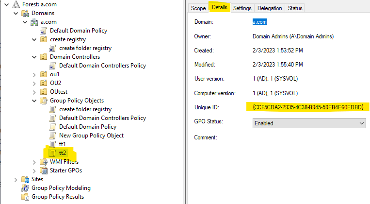

    3.Check the GPO name corresponding to {AEA1B4FA-97D1-45F2-A64C-4D69FFFD92C9}.
    ![](https://filestore.community.support.microsoft.com/api/images/3c32edf8-ea5a-4ed9-b49b-08db78a13ea9?upload=true&fud_access=wJJIheezUklbAN2ppeDns8cDNpYs3nCYjgitr%2BfFBh2dqlqMuW7np3F6Utp%2FKMltnRRYFtVjOMO5tpbpW9UyRAwvLeec5emAPixgq9ta07Dgnp2aq5eJbnfd%2FU3qhn54Ui9c7IY3%2BVaDGM794ieFEWFOTytTrMKy7m1XQpeIKlfhHZvv6qxFNypZh8EVO%2BjzMgLRnj7SrY%2FjVoV7qs8fDiK994oMxVrhrFAMYDcU%2FzowC8SNM3YdzzCkFwiQPqiCRNxEo7il4%2FZ13%2BJSKwY%2BsrAfo3dGDc2wIKthUv5RZgdJmJMnSQ%2BhXET7CyJ2QI%2FUmx3Q1VPQndUTLwoqifD3G%2BFYLJUESAQsQ9Socqdp1Vtck21K1fiyrUHrBX%2BzRsADTGM3zOF1iK8hzrpnV8uIwtym5N8MyDWaT0BuDtayD7c%3D)

    Thank you for your advise. However, i could not search the guid is exist in my domain controller server.
    Ping & NSlookup for the dc also no issue. I also run the repadmin command seems all are ok without any error.
    So really no idea what is happening on the DC server.
