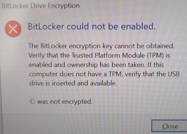

This didn't still trigger any auto apply both on Secure Boot enabled and disabled device. I've switched off the enabled one, and after logging back in I've received
I ran out of ideas what is happening. What I assume is that somehow the policy is not able to start the auto encryption, but why?

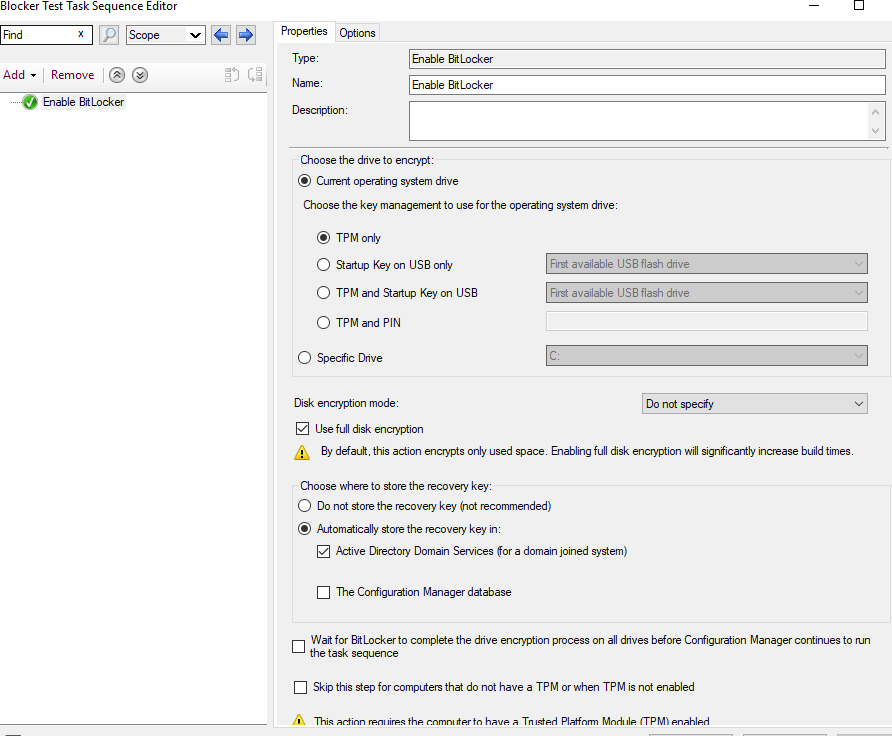

My workaround was to run a TS from MECM
It worked in few minutes on both Secure Boot Enabled and Disabled devices. I know the supremacy of MECM in many aspects, but the general decision is to unify security and some policies in one place, that would be cloud. This means it is only a temporary solution... Can someone give me some hints what could I test later on when I will be trying to do it via cloud again?
