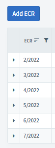

the result of the class is e.g : 2/2022
I've four questions :
  • The column ECR is not fill in table but it's rendering in UI. Why the value in column ECR is not write in the table?
  • As you can see the result is 002/2022 which is the calculation of max(Id,1)+1. How can I start at 002/2022?

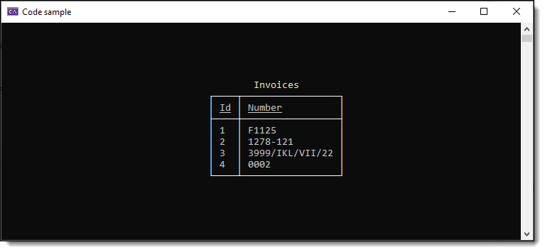

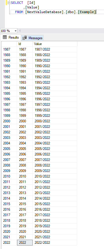

  1. Karen Payne MVP 35,596 Reputation points Volunteer Moderator
    2022-09-11T19:17:18.163+00:00
    Perhaps the following method will get what you want in regards to auto-increment. See it in action here
    public class Helpers
        public static string NextValue(string sender)
            string value = Regex.Match(sender, "[0-9]+$").Value;
            return sender[..^value.Length] + (long.Parse(value) + 1)
                .ToString().PadLeft(value.Length, '0');
