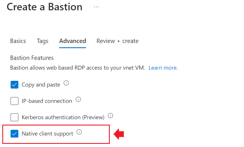

Hello,
Just wanted to know if there is any terraform script to enable native client support for Azure Bastion host. From the portal I can do it by the following way but not sure how to enable it via terraform script
Checked this doc below also but nothing as such mentioned regarding this
https://registry.terraform.io/providers/hashicorp/azurerm/latest/docs/resources/bastion_host
Thanks in anticipation.

    Hello @Atanu Gupta ,
    Welcome to Microsoft Q&A Platform. Thank you for reaching out & hope you are doing well.
    I understand that you would like to know if there is any terraform script to enable native client support for Azure Bastion host.
    If we check the Azure CLI commands for Bastion host, we can see that to enable native client support, we need to add the parameter "--enable-tunneling".
    Refer : https://learn.microsoft.com/en-us/cli/azure/network/bastion?view=azure-cli-latest#az-network-bastion-update
    And if we check the Terraform registry for Azure Bastion host, we can see this parameter is available.
    tunneling_enabled - (Optional) Is Tunneling feature enabled for the Bastion Host. Defaults to false.
    Note: tunneling_enabled is only supported when sku is Standard.
    So, to enable native client support for Azure Bastion host via Terraform, you need to add this parameter "tunneling_enabled" and set it to "true".
    I could not find any readily available script for this.
    Kindly let us know if the above helped or you need further assistance on this issue.
