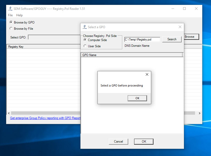

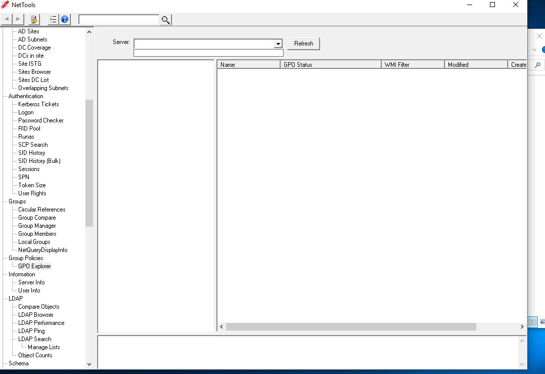

  2. Gary Reynolds 9,621 Reputation points
    2022-09-20T22:08:54.48+00:00
    Hi
    See the following post on how to read the contents of the registry.pol file - https://nettools.net/how-to-read-the-contents-of-registry-pol-files/
    Policy settings can also be saved in a number of other locations as well as the registry.pol file, have a look at this page which has details on how to view the details in the other location - https://nettools.net/gpo-explorer/ - GPO configuration Settings
