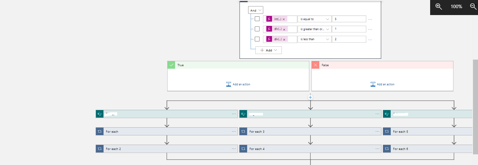

    For your reference sharing the condition to check whether it is 2nd Friday or not of the month.
    The first condition check whether today's day is Friday or not (i.e. Sunday is 0 so Friday will be 5)
    The second and third condition get the day of the month and divide it by 7 to get know if falls under greater than 1 or less than 2 (the condition will tell whether it is 2nd Friday or not)
    As these are and condition so all the condition should be true to run your true condition which will further have your workflow.
