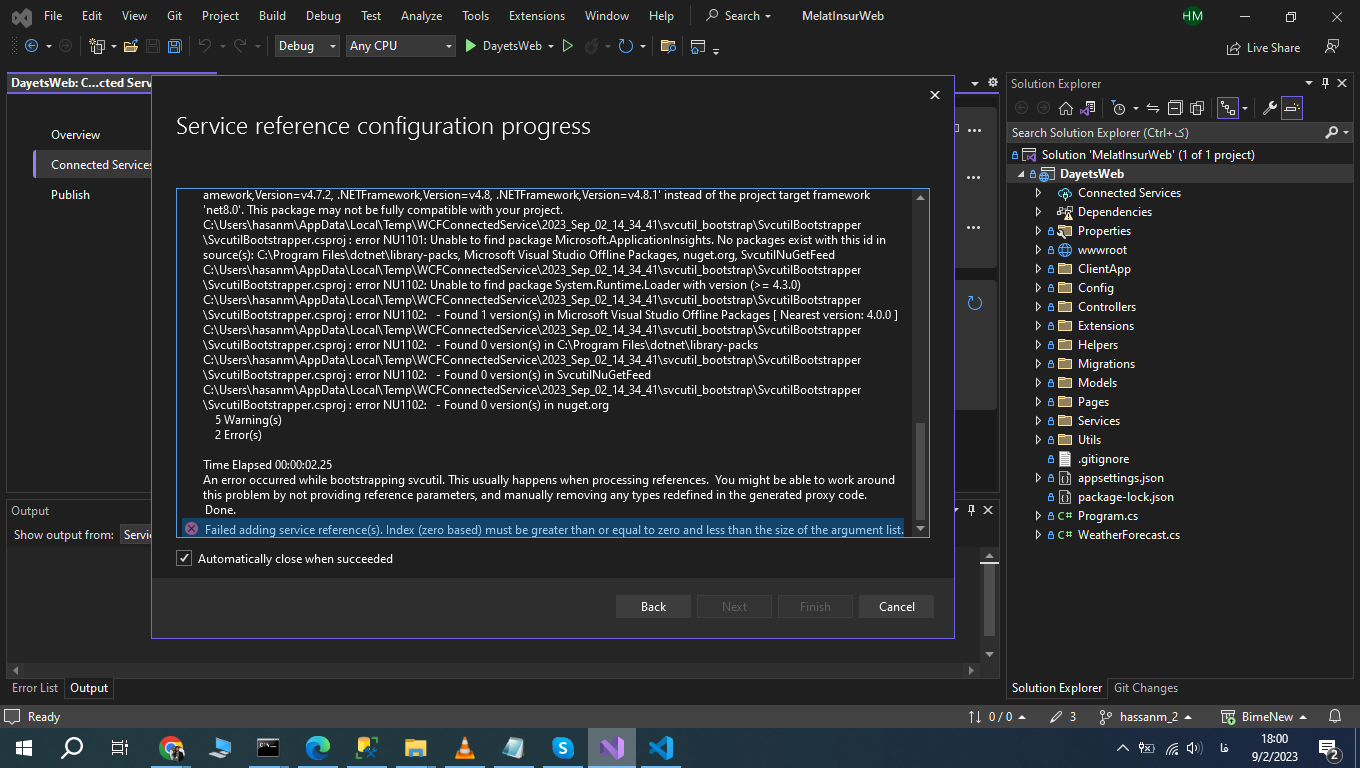

  3. hassan moradi 0 Reputation points
    2023-09-02T14:30:13.61+00:00
    Hello, I want to add a service to my project, but I get this error
