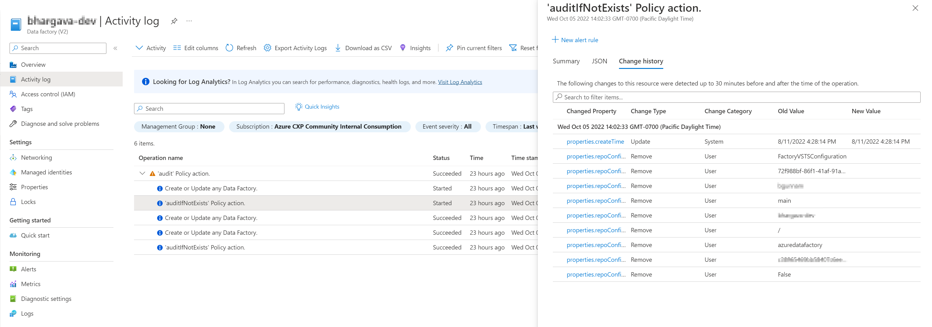

  1. Bhargava-MSFT 31,261 Reputation points Microsoft Employee Moderator
    2022-10-06T18:25:15.457+00:00
    Hi @Krishnamohan Nadimpalli ,
    Sorry for the delayed response.
    Yes, you can submit a support request to get the details from the support team.
    Please note there is a retention policy on the back-end logs(I believe it's 30 days). I hope this helps.
