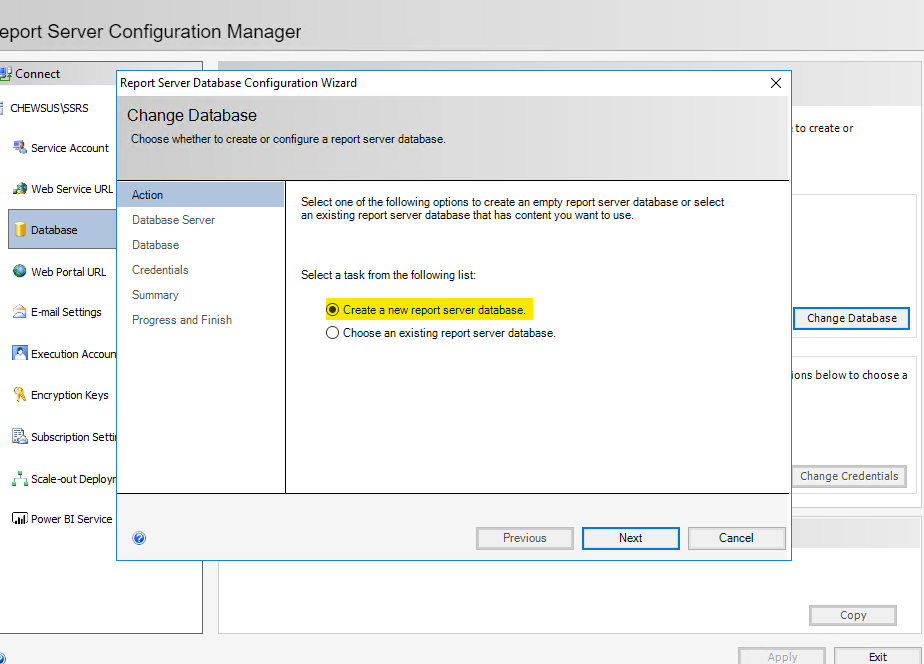

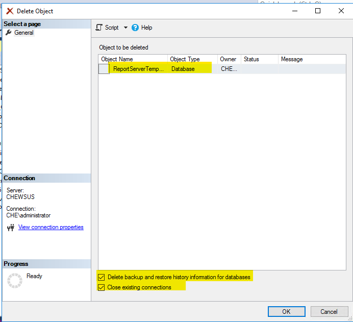

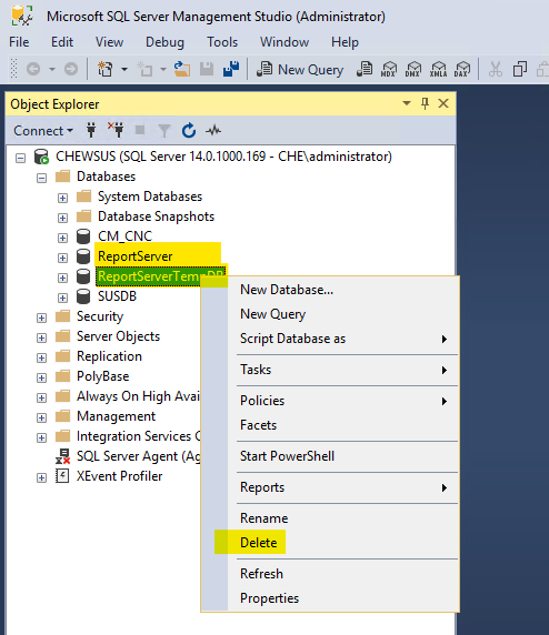

    1) Did you delete the related databases after you uninstalled Reporting Services? For example:
    2) If the related database is not deleted, please delete it and create new one when configure Report Services.

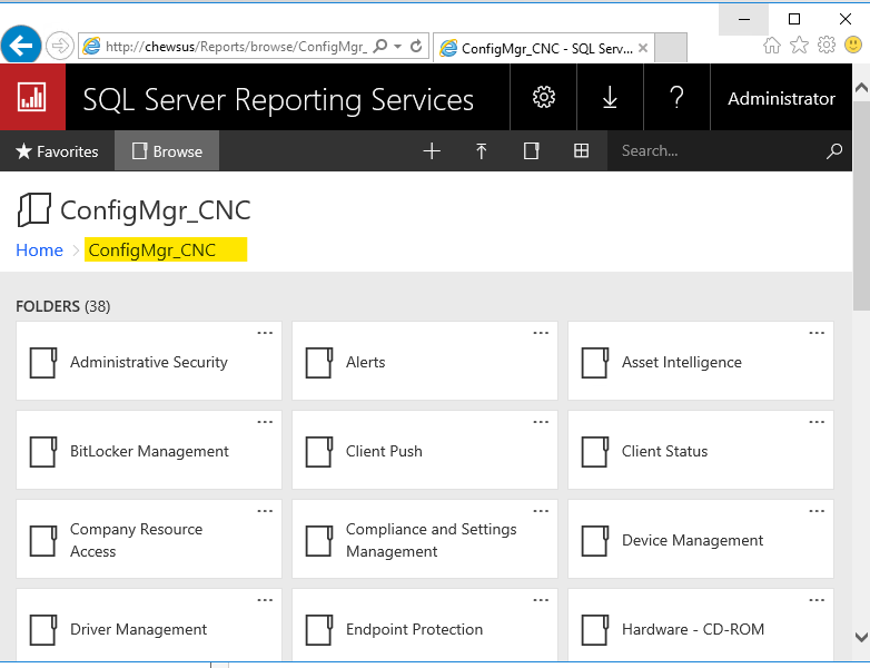

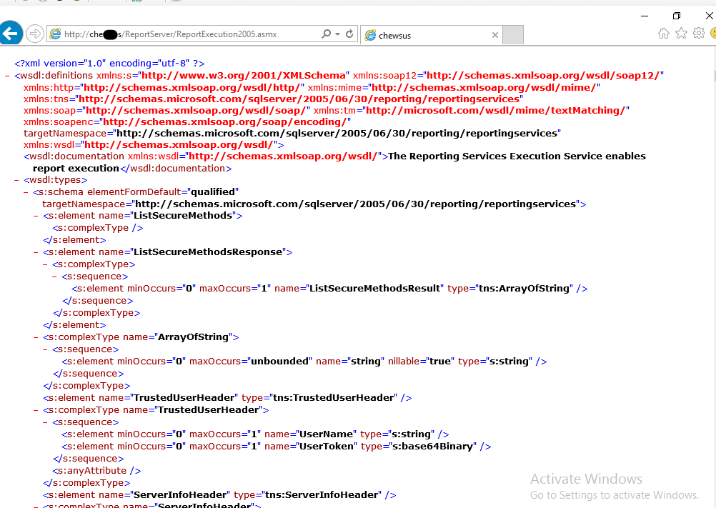

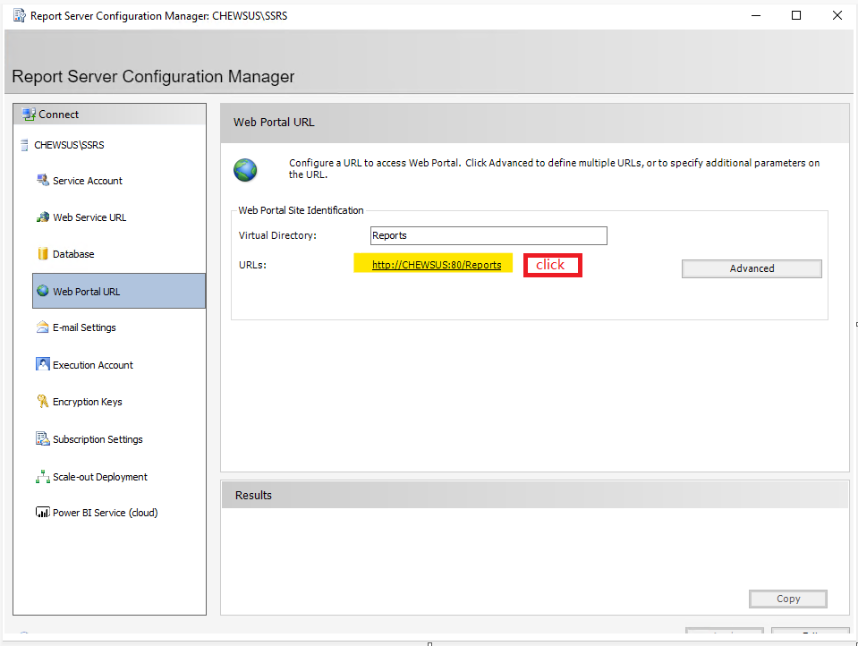

    3) Confirm that SSRS is working correctly. For example:
