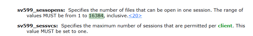

    The specification "[MS-SRVS]: Server Service Remote Protocol" says:
    sv599_sessopens: Specifies the number of files that can be open in one session. The range of values MUST be from 1 to 16384, inclusive.<20>
    <20> Section 2.2.4.46: The allowed range of values on Windows NT 4.0 is 1 to 2,048, inclusive.
    There are various hints that this is an SMB server parameter.

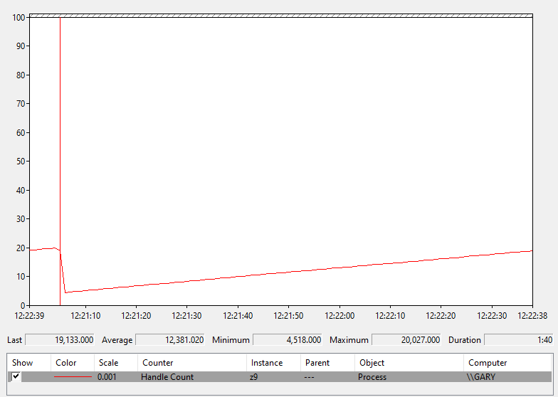

    Hello Bo,
    I wrote a short test program to open 20,000 files on an SMB share and it ran without error. To be sure that 20,000 plus handles were concurrently open (i.e. no major bugs in the test program), I monitored the open handles count with perfmon:
    I think that there is some doubt about the real cause of your problem.
