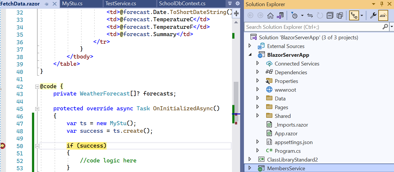

    It seems that you create and implement new netstandard2.0 class library (or service) that reference another service project built on .net framework v4.7.2, and now you'd like to perform EF database operations by consuming new methods in netstandard2.0 project from Blazor Server app.
    You can try to install EntityFramework in Blazor Server app, then build and run the project to check if it can work as expected.
    <PackageReference Include="EntityFramework" Version="6.4.4" />
    Testing code below work well on my side, you can refer to it and compare with your projects.
    Call method in netstandard2.0 project from Blazor server app
    var ts = new MyStu();
    var success = ts.create();
    if (success)
        //code logic here
    Method in netstandard2.0 project
    public class MyStu
        public bool create()
            var ts = new TestService();
            return ts.CreateStudent();
    Method CreateStudent in .net framework v4.7.2 project
    public bool CreateStudent()
        SchoolDbContext db = new SchoolDbContext("connection_string_here");
        db.Students.Add(new Student
            FirstMidName = "F",
            LastName = "L"
        db.SaveChanges();
        return true;
    Test Result
