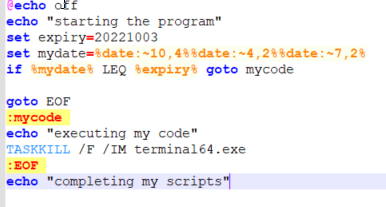

    If you have may statements to execute in if statements, try to use goto. Refer: https://learn.microsoft.com/en-us/windows-server/administration/windows-commands/goto

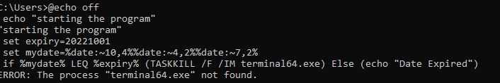

    Find the sample output for the script where I set the expriy as Second October
    see the execution of else part when I set date as 1st October

  1. P Joshi 21 Reputation points
    2022-10-02T07:16:11.897+00:00
    Thank you for your help - its close to what i am looking to achieve. I am not very knowledgable about the codes.
    If i want to insert this taskill code to the above code, how can i do it?
    TASKKILL /F /IM terminal64.exe
    The above code has the date and i ran in cmd prompt and worked as shown above. How do i include TIME as well to the above code.

    I have put the date as 1st of October but it is still executing the code, it should be giving date expired. Am i doing something wrong?
    The date displayed in cmd is this: Sub 02/10/2022. If i put date format as 01102022 it gives date expired, and if i put 03102022, it still gives date expired
    Sorry for many questions
  3. P Joshi 21 Reputation points
    2022-10-02T09:35:58.043+00:00
    Looks like my system date is shown as yyyyddmm, now it works correctly. Thank you. I also need to compare time value just like the date. If i have need an expiry date and time as 3 Oct 2022 at 14:00 pm then how can i achieve it? Thanks
  4. P Joshi 21 Reputation points
    2022-10-02T10:10:59.25+00:00
    thanks, below i added the hour and minute to the date but for some reason its reading it as true while it should be false
    expiry is 01 Oct 2022 2100 and system date time is 02 Oct 2022 2106 - it should be giving date expired but isnt
