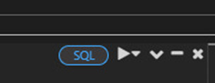

However, if I create a cell at the end of the notebook (not in between existing cells). And then set the language to SQL using this button, the code will be correctly interpreted as SQL.

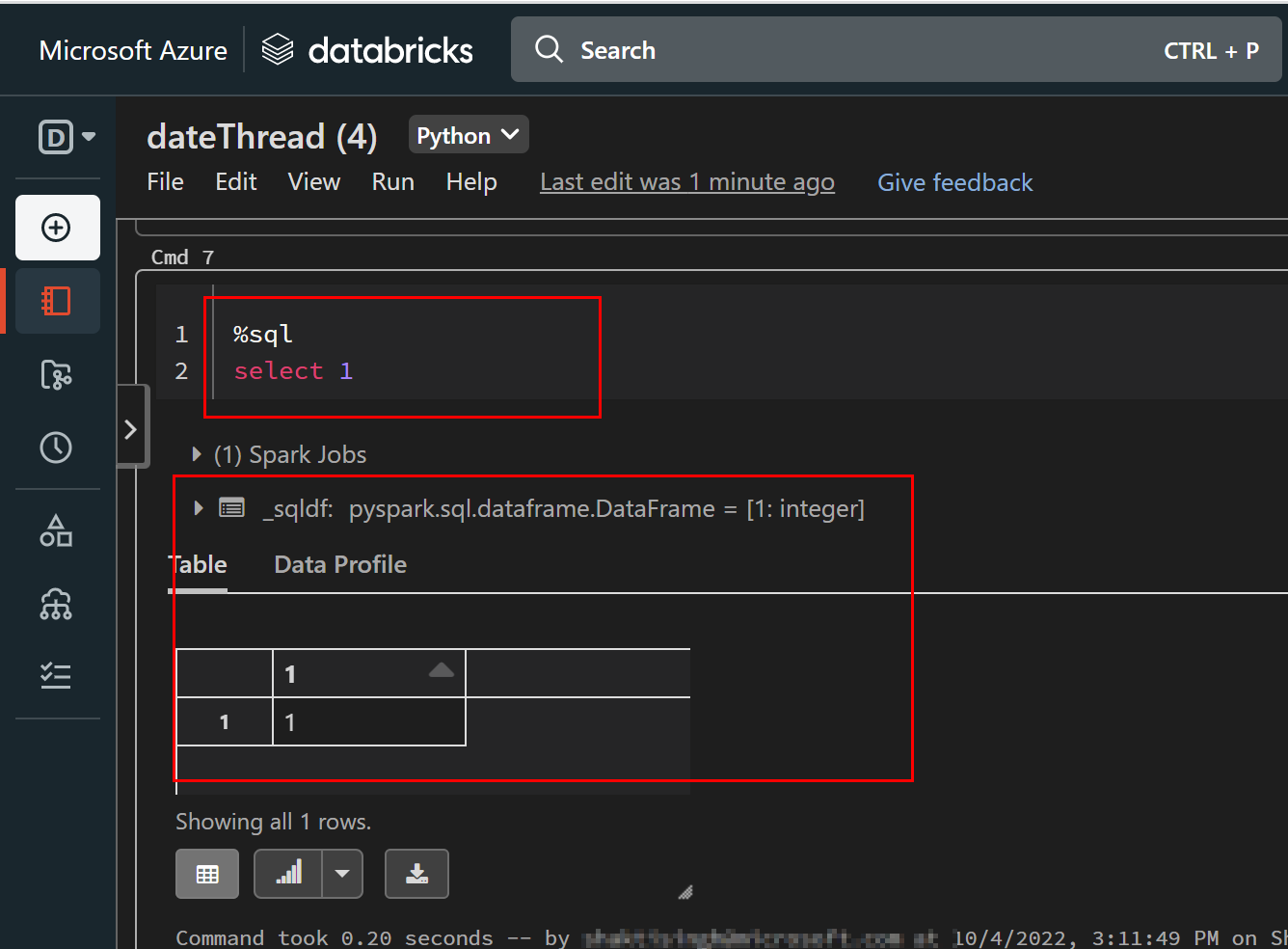

    That output you have is what I had previously (before I started having issues).

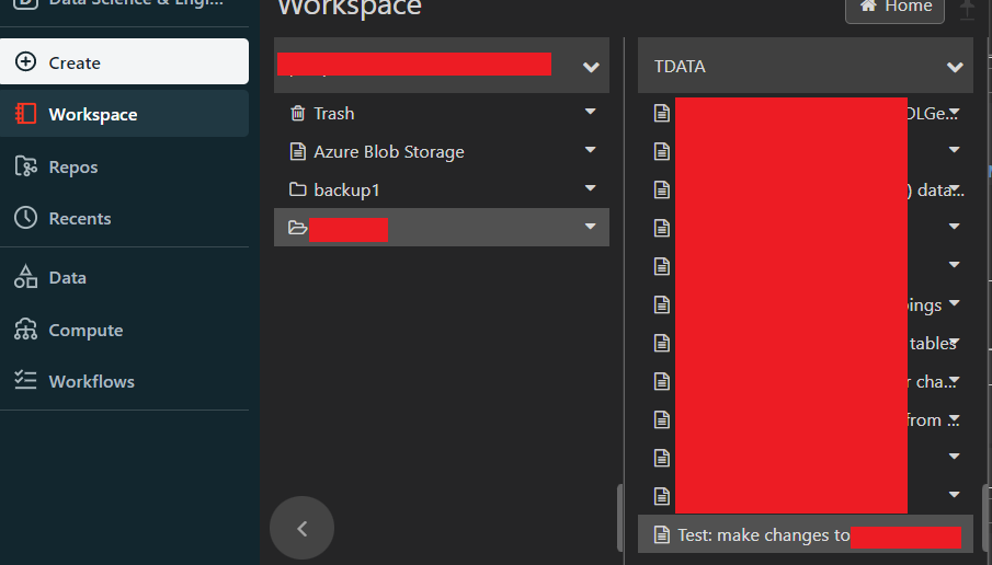

    I believe the notebook in in workspace, not DBFS. I wasn't entirely sure how to check, but from this I believe it is in Workspace?

    I don't have Git repositories linked to Databricks, and I have not had one set up in the past.
    Therefore I think none of these points are an issue.
