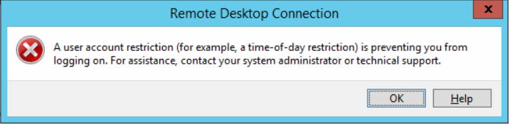

    Thanks for your response and your testing. You are right indeed, I temporarily disabled NLA and got the same result. The error message I'm getting is:
    I'm connecting with a Domain Admin account and the IP is a 100% correct. No issues at all when I connect on hostname instead of IP. Must be some policy or setting somewhere which I forgot.
