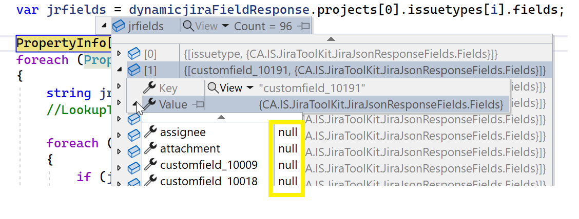

I tried the previous suggestion but the field list is empty
    public class Issuetype
        public string self { get; set; }
        public string id { get; set; }
        public string description { get; set; }
        public string iconUrl { get; set; }
        public string name { get; set; }
        public string untranslatedName { get; set; }
        public bool subtask { get; set; }
        public string expand { get; set; }
        //public Fields fields { get; set; }
        public Dictionary<string, Fields> fields { get; set; }
My Sample code
       var dynamicjiraFieldResponse = JsonConvert.DeserializeObject<Root>(strJsonResponse, new JsonSerializerSettings
                        MaxDepth = 2000
                    if (dynamicjiraFieldResponse!= null)
                        for (int i = 0; i < dynamicjiraFieldResponse.projects[0].issuetypes.Count; i++)
                            var IssueTypeName = dynamicjiraFieldResponse.projects[0].issuetypes[i].name;
                            var IssueTypeId = dynamicjiraFieldResponse.projects[0].issuetypes[i].id;
                            var jrfields = dynamicjiraFieldResponse.projects[0].issuetypes[i].fields;
                            PropertyInfo[] properties = typeof(Fields).GetProperties();
                            foreach (PropertyInfo property in properties)
                                string jrFieldName = property.Name;
                                //LookupType lookupType;
                                //Here I want to loop through the response

    All my response is null - i think its not serializing
    You did not share this code! The example I used above returns a file stream which is no different then reading an HTTP response. If the problem is your REST service is not returning JSON then debug your service.
