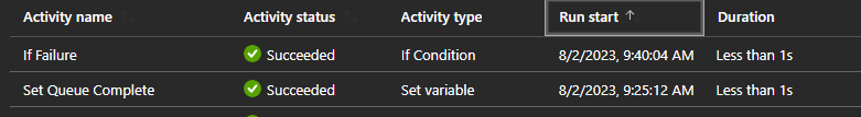

  4. Christo Greeff 6 Reputation points
    2023-08-02T08:28:10.86+00:00
    We're seeing similar behavior. The UNTIL activity runs for 20-25 minutes and then we're seeing a delay of 15 mins before the next activity continues. 15min gap between last activity inside the UNTIL, and the start of the IFCONDITION activity after OnSuccess.
    What are the cost implications here? Do we need to escalate this @ShaikMaheer-MSFT ?
  5. Viguro 1 Reputation point
    2023-08-02T08:50:16.4233333+00:00
    We (partially) solved the problem as follows: instead of retrieving the job status every 10 seconds, we retrieve it every 5 minutes. In this way, we drastically limit the number of loops and have reduced the "dead time" from 30 minutes to less than 2 minutes for an 8-hour process.
