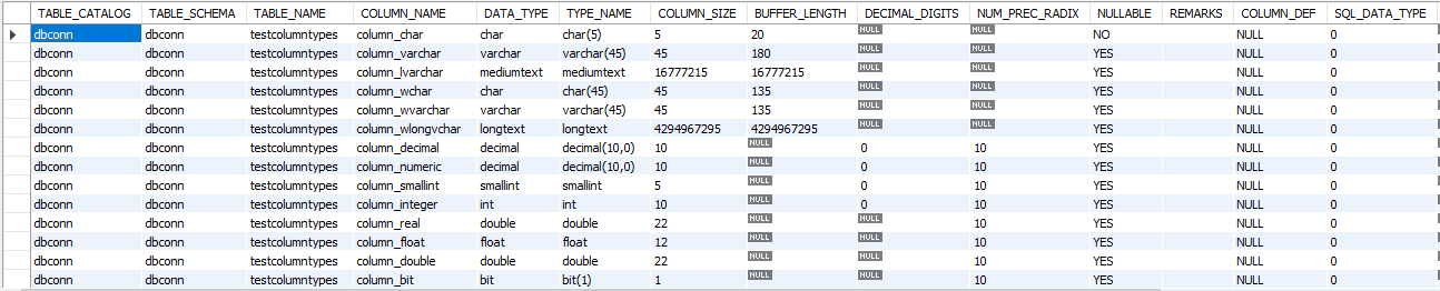

The MySQL server logs are attached - 249743-mysql-log-no-i-is-disabled.log and 249751-mysql-log-no-i-is-enabled.log. Manually executing the query given when NO_I_IS is disabled appears to return correct information on the table. A screenshot of this query's output is also attached - 249753-mysql-metadataquery.png.
